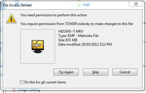

however i am having a very annoying permissions issue. i saw a post somewhere about it however i couldnt find a fix???
i download all my files through pyload to a share "downloads"
however i cant delete the files. i can rename the folders but i cant do anything but read and execute the files.
HELP???
HELP???

I had a play through these settings but cant seem to get them right. i have tried setting it to 777 and that prevented all access to my server.. i had to run the new permissions script. :\

/mnt/downloads is most likely NOT a real directory.
It is likely being created by my script but /mnt/downlods is NOT a standard disk and it is likely in RAM.
/mnt/user/downloads would likely be more correct, or /mnt/disk1/downloads.
yeah that was actually a miss type by me. it is actually downloading to /mnt/user/downloads
thats where the files are appearing. but i just dont have permissions to delete them.
screen shot included
OK, get me the output of:
ls -al /mnt/user/downloads
here you are :)

1. What are the share settings on the downloads share (public/secure/private/etc)?
2. What user are you using to connect to the server (root/user_you_created)?
3. Have you downloaded anything since running the new perms script?
it is a private share.
i am connecting with an account i created called admin
yes i have with no luck :(
Any thoughts?
