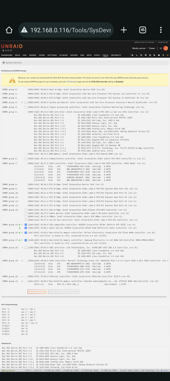

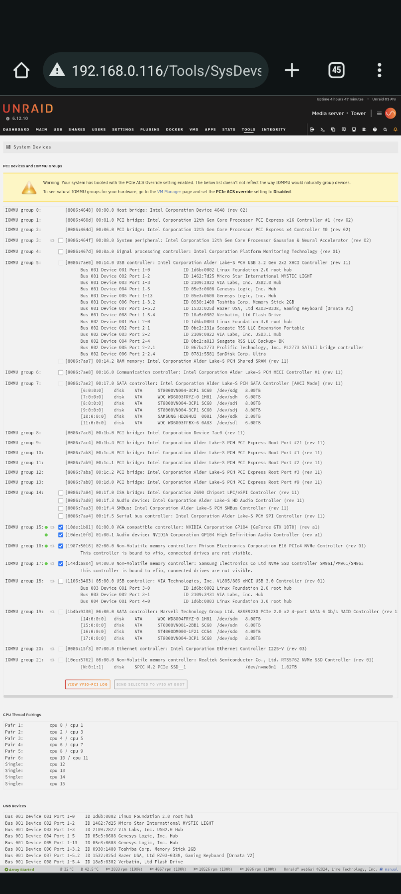

I've looked in System Devices and it isn't showing there.
Then it's not being detected, that's not a software problem, could be the controller or the m.2 slot in the board, you can test in another board to confirm it's working.
