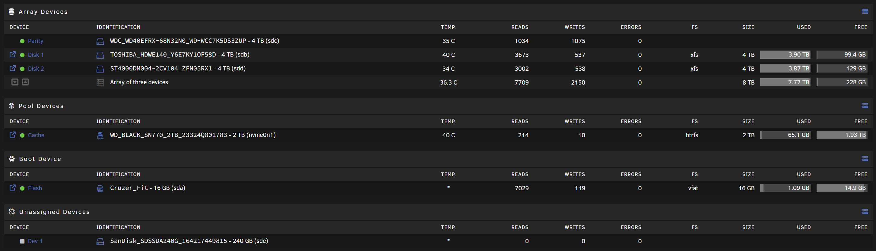

My 3 hard drives never spin down more than a minute. As soon as they spin down (either after the 45min delay or after I manually spin them down), all 3 of them turn back on after a few seconds. I don't often check my Unraid dashboard (let's say once a week), so I can't precisely say when this started happening.
Here are my drives :

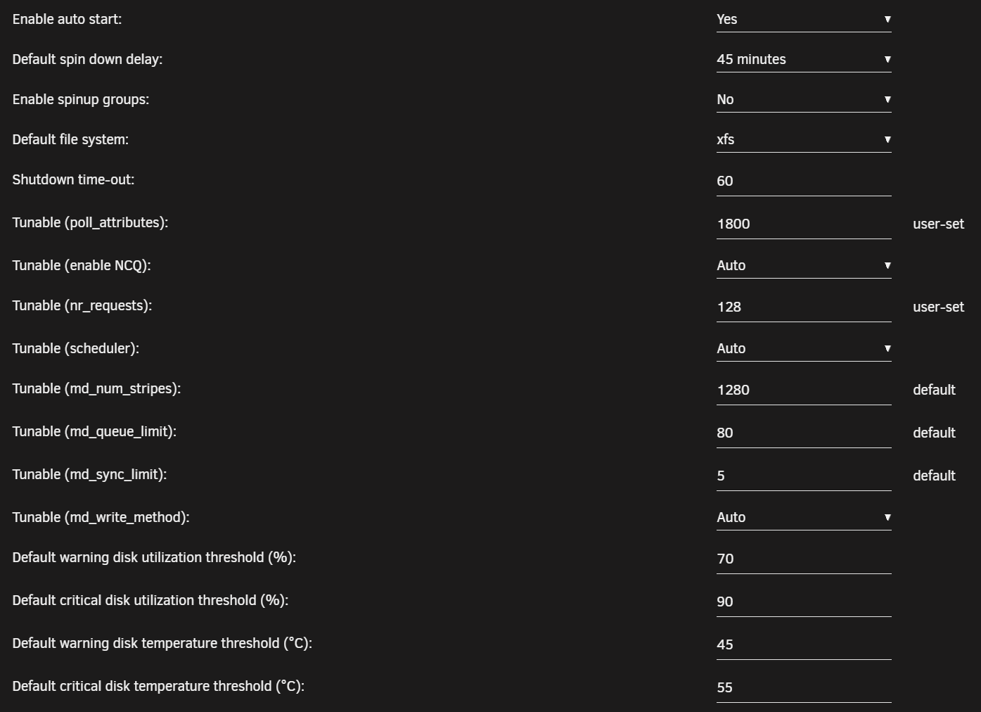

Here are my general disk settings :
Any ideas?
