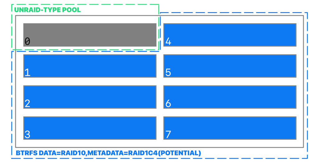

I had been drafting a question over what you mention, for weeks now; the required Unraid array in a pure ZFS setup (I wasn't sure if it was my mistake preventing the start of the pool), so I've been thinking about exploring the pure Btrfs pool angle. My question was about that. RAID5/6 aside, Btrfs is kinda low key superior to ZFS because of its flexibility, but there's nothing about Btrfs metadata/system/data profiles or setting up a pool outside of the context of cache.

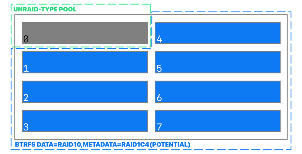

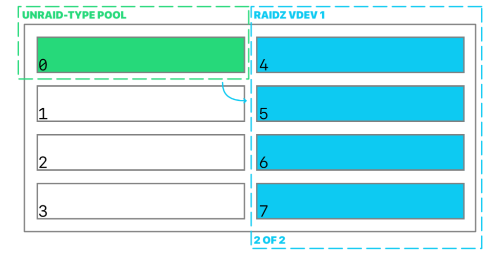

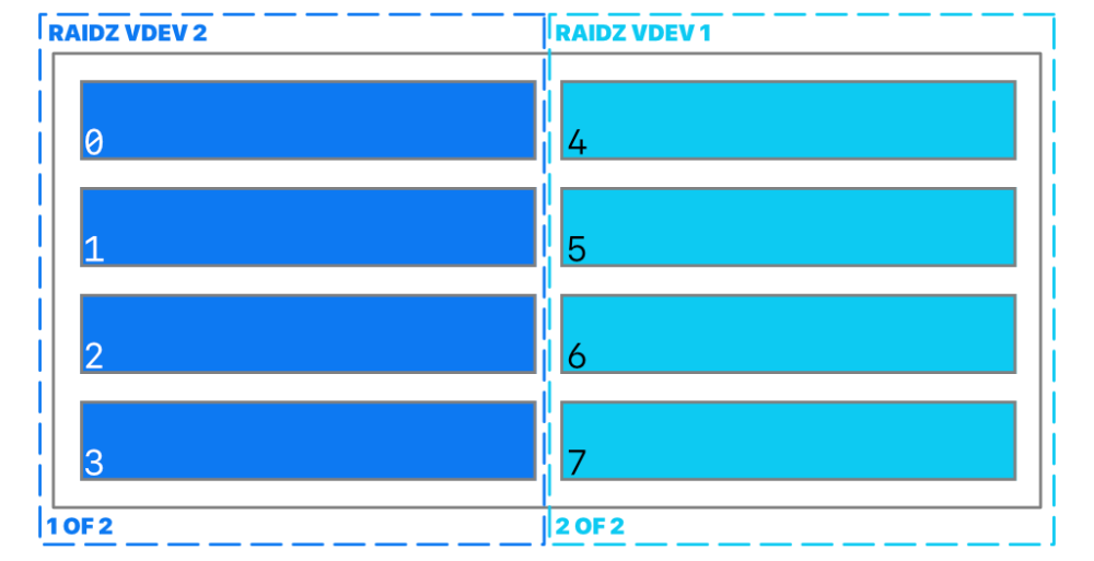

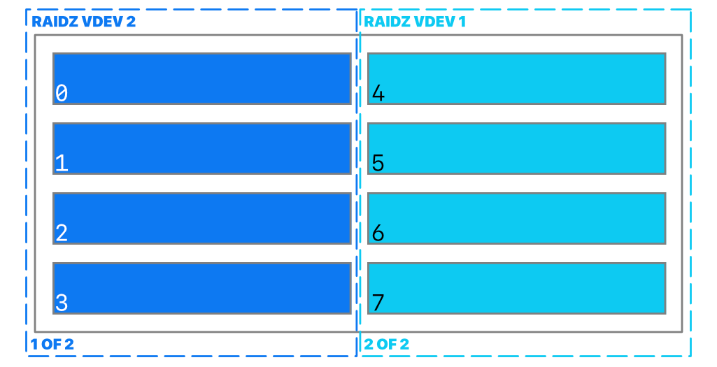

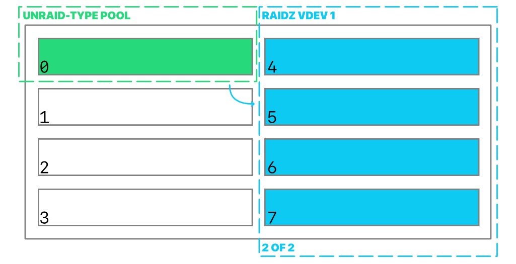

Just today in the morning, I was still on it, making some drawings (attached) to help me illustrate a post I couldn't get under control and then…power went out. Talk about anticlimactic.
