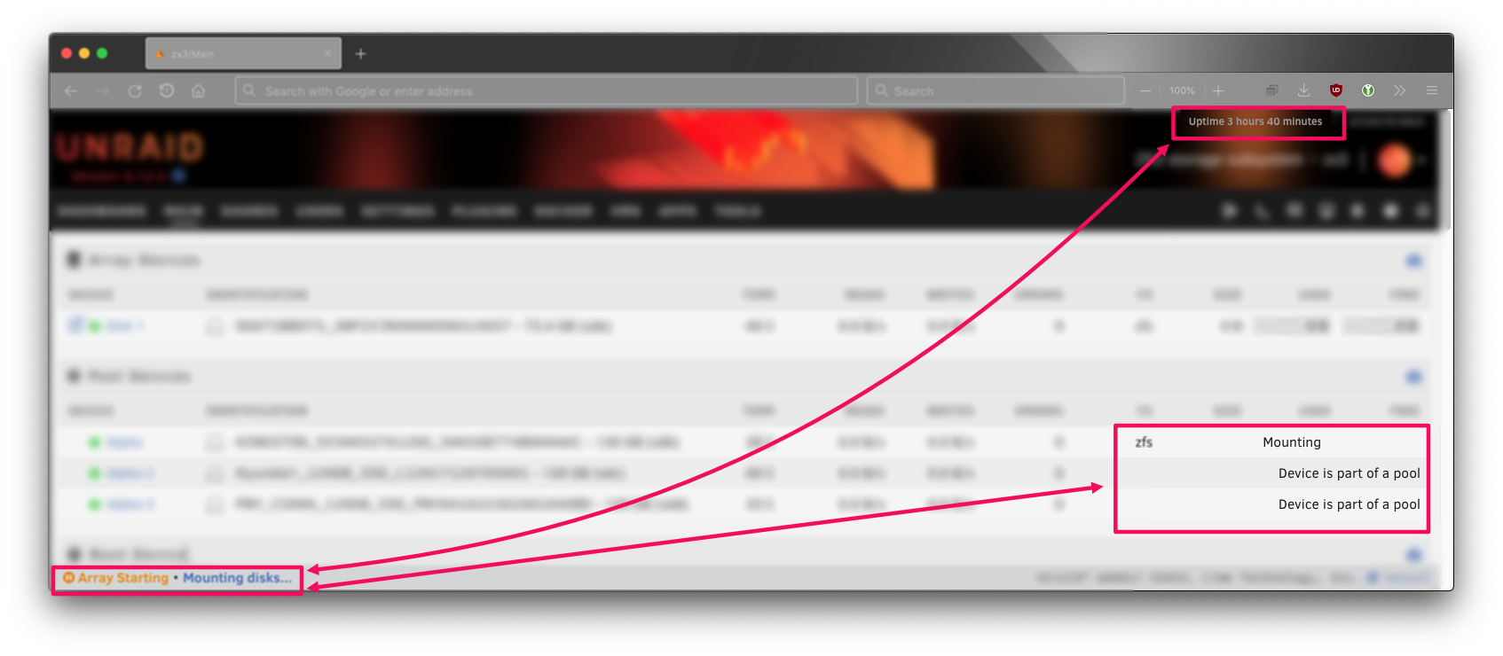

  5. I have a small app server that needs very little space, mostly for binaries as it uses the network for everything else. Nevertheless, that very little space is in the form of a handful of virtual machine disk images. It makes no sense "checking out" relatively giant VM files from the array to a cache disk if those files are the norm, so I opted to change the storage for a small ZFS flash mirror instead so they can be worked with in-place. The server was initially configured with an Unraid array, which I cannot get rid of. In the GUI, unless hidden files are, well… hidden, the Unraid array appears to be empty already but when I remove it from the system it tells me too many disks are missing or something like that as if there was something in the array it needs. I took a few screenshots to help me illustrate my point: I cannot log in via SSH to see if there are any ZFS snapshots or datasets (from the brief period the Unraid array was used for containers) because it's locked up, there is some error about sshd having too many open ports or listening in too many ports or something along those lines. Regardless, since everything was moved to the ZFS pool, I don't see why should there be anything lingering in the array at least from the ZFS standpoint. Could you help me out with some pointers on how to remove the array, please? This is Unraid 7.1.3, BTW. Thanks!

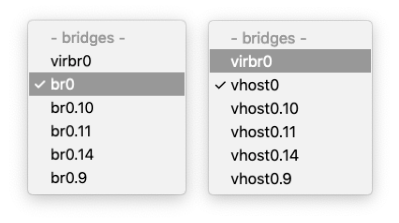

  6. I just found this: macvtap's libvirt XML definition ... <devices> <interface type='network'> <mac address='52:54:00:0a:8a:c1'/> <source network='ovs-bridge-eth1'/> <model type='rtl8139'/> <address type='pci' domain='0x0000' bus='0x00' slot='0x03' function='0x0' multifunction='on'/> </interface> <interface type='network'> <mac address='52:54:00:0a:8a:c2'/> <source network='macvtap-bridge-eth2'/> <model type='rtl8139'/> <address type='pci' domain='0x0000' bus='0x00' slot='0x03' function='0x1'/> </interface> ... </devices>Source: https://suhu0426.github.io/Web/Presentation/20150203/index.html I noticed the VM definition thingy now presents both the breakdown of the XML side by side together with much easier to digest boxes too, it should take out much of the guessing for the vSphere immigrants who've never had to deal with this sort of thing before. Since the last post, now I'm running Unraid baremetal, but I have yet to check it out to confirm it works on it. I tried a couple of things but then the DNS cache expired (DNS servers and edge firewall were offline; project got just a bit out of hand) and things got very ugly very fast after that. If it works I'll make sure to confirm back. 🤓 I've no objections on being beaten to it though. For what it's worth; in the logs and drivers section (in Tools→System Drivers) there is mention of macvtap being loaded. I'm optimistic. But still, Unraid? Buddy? You alive? Sh— Should I check on the news? Did a night time "employee" stole your wallet and keys when you fell asleep, again? 😒

  8. So… the Silverstone one, I made that one the very first time it was requested, but I didn't like how it came out. I'm not a designer, much less an actual artist, and I think it takes a real artist to simplify a design to a few lines. Mine keep coming out too detailed, that's bad for an icon. And as far as the UGREEN ones, I think they can be used as they are, they almost look like icons if you squint. It will be tiny, you will barely gonna notice: I liked the design both in and out of the Jonsomething, John Deere, whatever. It reminds me to this — I think it was a kickstarter — something about "zima", but the Lil' Jon looks better. In any case, I made them all, but since they're lousy designs (again I'm not a designer); if a real designer wants to take them up I'm attaching the original Affinity Designer file, SVGs and PSDs so they don't have to start from scratch. Very unrelated: have you noticed the 4bay UGREEN thing from the front? I think might be a perfect square. After tracing it, I noticed it was only one pixel of difference from the other side, and I think only because the image was zoomed it way too much, I thought that was y'know… I don't know. Never mind. I must be having hot flashes or something. Have fun. UGREEN NASync DXP4800.psd UGREEN NASync DXP4800.svg UGREEN NASync DXP2800.psd UGREEN NASync DXP2800.svg Jonsbo N3.psd Jonsbo N3.svg Silverstone RM21-308.psd Silverstone RM21-308.svg case icons.afdesign

  12. Scratch that, I couldn't wait. I did zpool import disk1 to import the main array without starting the thing, it succeeded. Therefore, that's the asnwer to the question. However, in regards to what I wanted to do, it didn't quite work, the problem that appeared earlier when attempting mounting the pool the system would hang forever (and show some micro kpanics) is still there. [Wed22@ 6:15:58][root@zx3:~] #〉zpool import alpha Message from syslogd@zx3 at Nov 22 06:16:46 ... kernel:VERIFY3(size <= rt->rt_space) failed (281442912784384 <= 2054406144) Message from syslogd@zx3 at Nov 22 06:16:46 ... kernel:PANIC at range_tree.c:436:range_tree_remove_impl() I haven't given up though, I think I still might have an idea or two. Thanks! =]

  14. Oh yeah, my bad. I just caught on. Thanks for correcting me. I'll do that and come back. It might take a little bit, I had reinserted the ESXi SD card to check on something. It goes inside the giant heavy toaster. 😔 Thanks!
