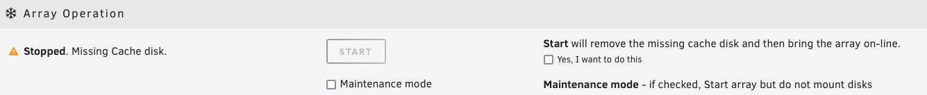

I log in to mount it manually the pool (auto-mount is temporarily disabled) but it tells me I have a missing cache disk and won't let me start the array without extra steps. I'm not sure what it's talking about since I don't have a cache anything; it's an all-flash ZFS pool, there's no need. I have one other obligatory disk in the regular array but it's empty and doesn't have any of the supporting pools (parity, cache).
1425464214_ScreenShot2023-11-22at02_02_23.thumb.png.a955d2610a2bae7a91f913d536a17581.png
Does it refer to this pool – the ZRAID one – as the cache?
And followup: when it says "remove the missing cache disk" does it mean the individual disk drive or the volume "disk" would be?
And followup of the followup: if it means the whole pool, how do I get it to mount degraded then?
I can't remove one disk while mounted to degrade it live because that's why I'm trying to get it to mount degraded, it won't mount when it's normal.
