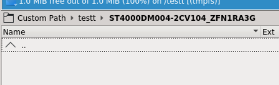

  12. Had to rename my Centon DataStick PRO usb2.0 to UNRAID for it to work too.

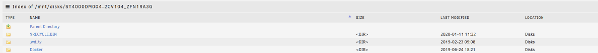

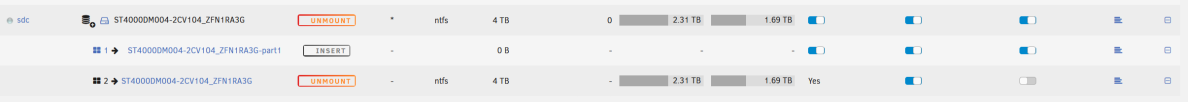

  13. That's logic enough, and it did seem to get me a bit further, thanks. Okay, I had to map the drive to make it work, not just the "disks" folder. Thanks a lot for making me look at the right place.
