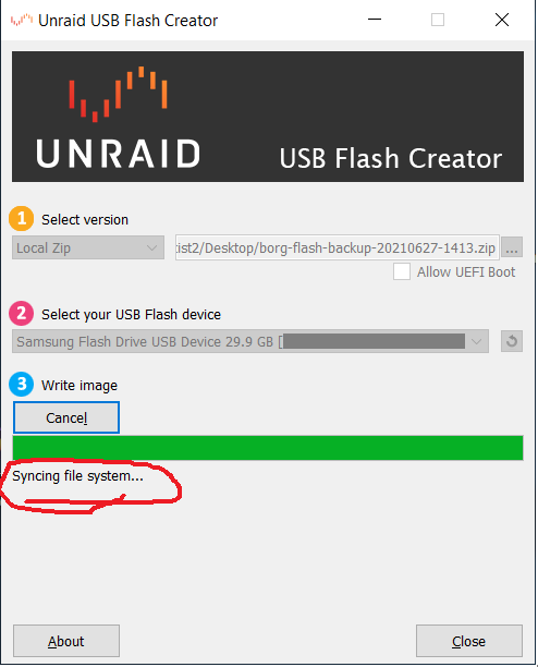

stuck at "Syncing File system..." on new USB setup?
I'm setting up a new USB stick and it keeps getting stuck here. Any suggestions?

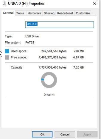

  • Have this exact issue, where the tool stops processing, and resizes the drive to ~7Gb, as others have seen. I ensured the drive was labelled "UNRAID", tried changing the block size allocation, running

This is still definitely an issue.  I have been testing Unraid via the Trial on an old USB stick for a few days while I build my new Unraid server.... ordered a new Sandisk Cruzer (Sandisk 32GB Cruzer Fit USB 2.0 Flash Drive (SDCZ33-032G-G35), and when trying to write the ZIP backkup of my original Unraid USB (backed up via Web UI) I consistently got the very same result with it immediately freezing with status "syncing file system".  After attempting some of the workarounds here I did get it to write by manually formatting & renaming the USB drive name while it showed the error "syncing file system", to which the USB installer would resume and appear to complete, but only ~7GB of the 32GB was shown as being formatted, and needless to say it wasn't bootable.

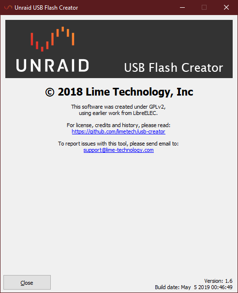

Had a minor issue as well with the creator (Win32 1.6) getting stuck at the "syncing file system" stage on my 16GB Kingston DT Rubber 3.0 connected to an USB 2.0 port.
Closed the creator, opened up Disk Management, saw the drive named as UNRAID but with no letter so I added one, ran the creator again and this time it worked.
Go figure.

Confirmed That renaming the drive while it's stuck at "syncing the filesystem" worked for me. It "unstuck" immediately. Crucial 4GB gizmo.
