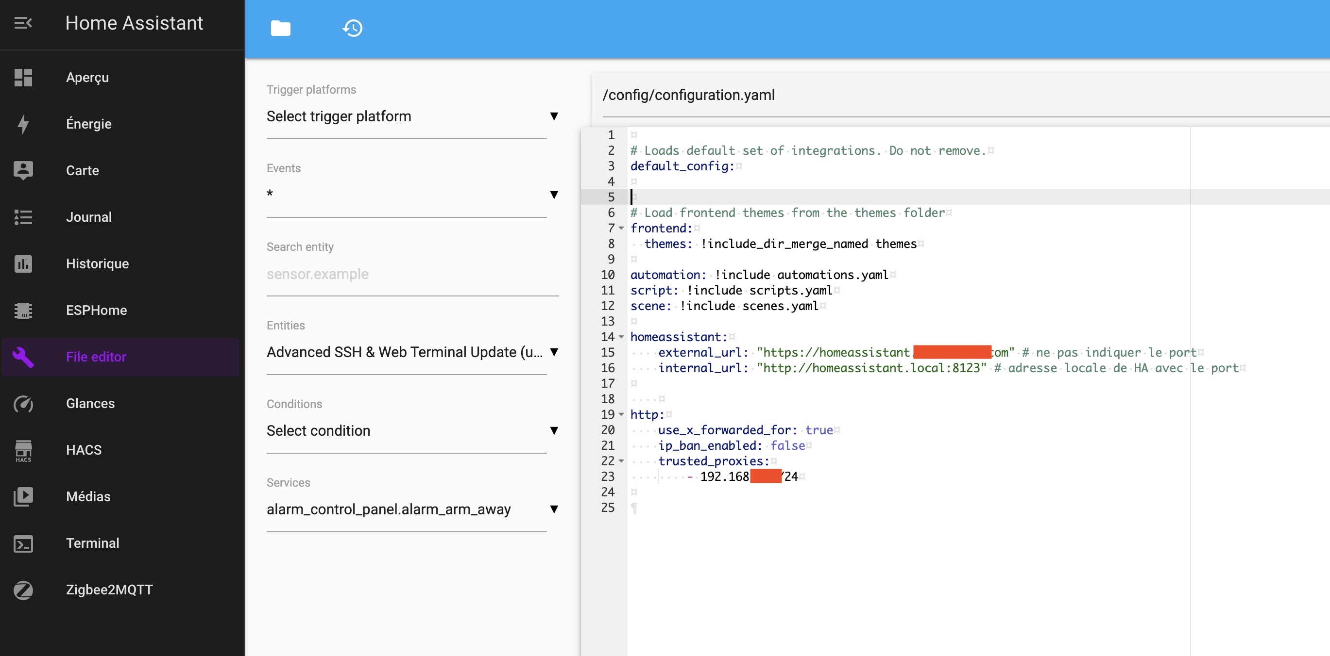

On Home Assistant, edit your configuration.yaml (with the file editor HA plugin) :
homeassistant:
    external_url: "https://subdomain.domain.com" # provide your subdomain and domain, with no port
    internal_url: "http://homeassistant.local:8123" # local address with port
http:
    use_x_forwarded_for: true
    ip_ban_enabled: false
    trusted_proxies:
        - 192.168.X.X/24 # replace X to fit your local devices

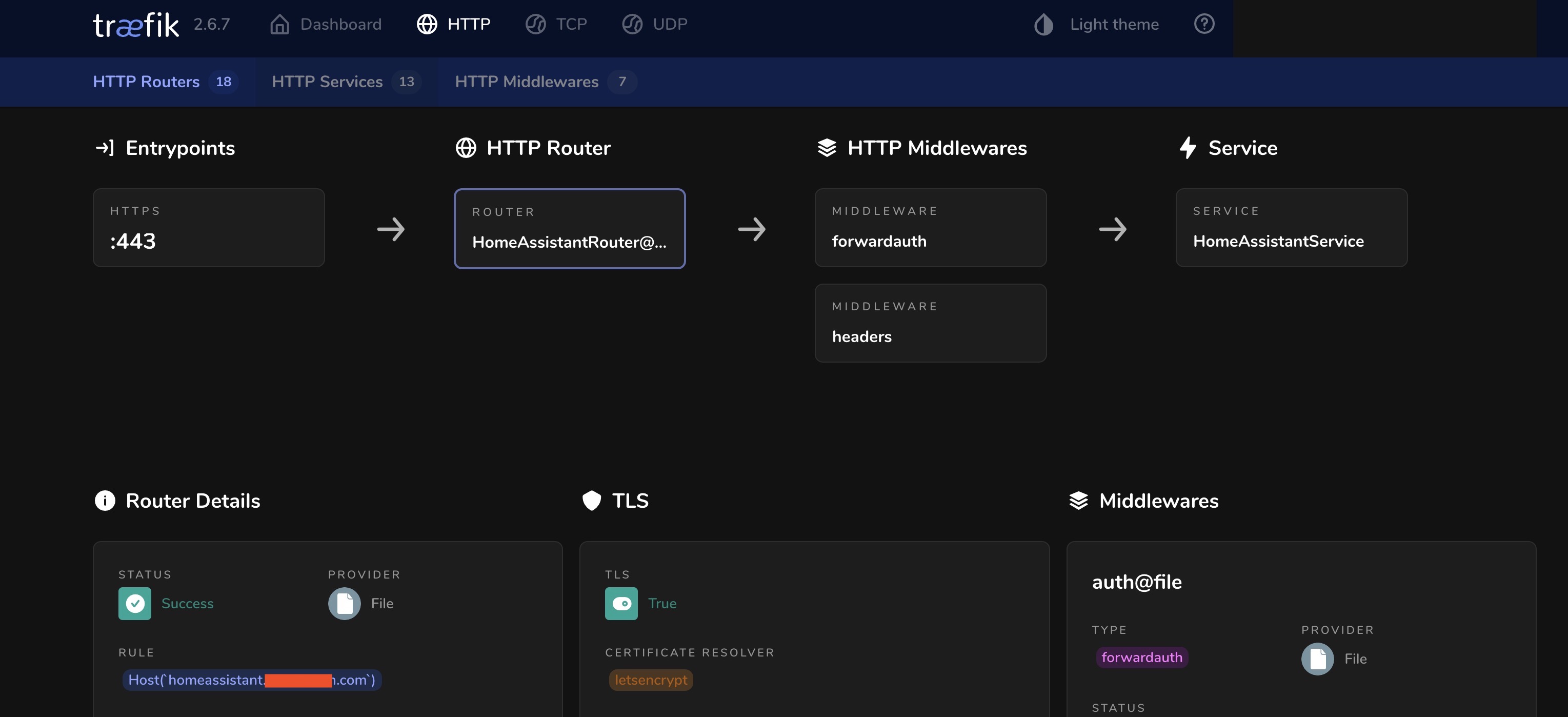

On Traefik, edit fileConfig.yml, to include under "http:", and edit the following :
  • subdomain
  • domain
  • localip
  • localport
  • auth (if not already named auth, must be replaced with the identifier of your middleware)
  ## EXTERNAL ROUTING - Only use if you want to proxy something manually ##
  routers:
     HomeAssistantRouter:
       entryPoints: https
       rule: "Host(`subdomain.domain.com`)"
       service: HomeAssistantService
       middlewares:
         - auth
  ## SERVICES ##
  services:
     HomeAssistantService:
       loadBalancer:
         servers:
           - url: http://localip:localport
Then go check on Traefik's UI to see if there's any error being reported. It should be all green.

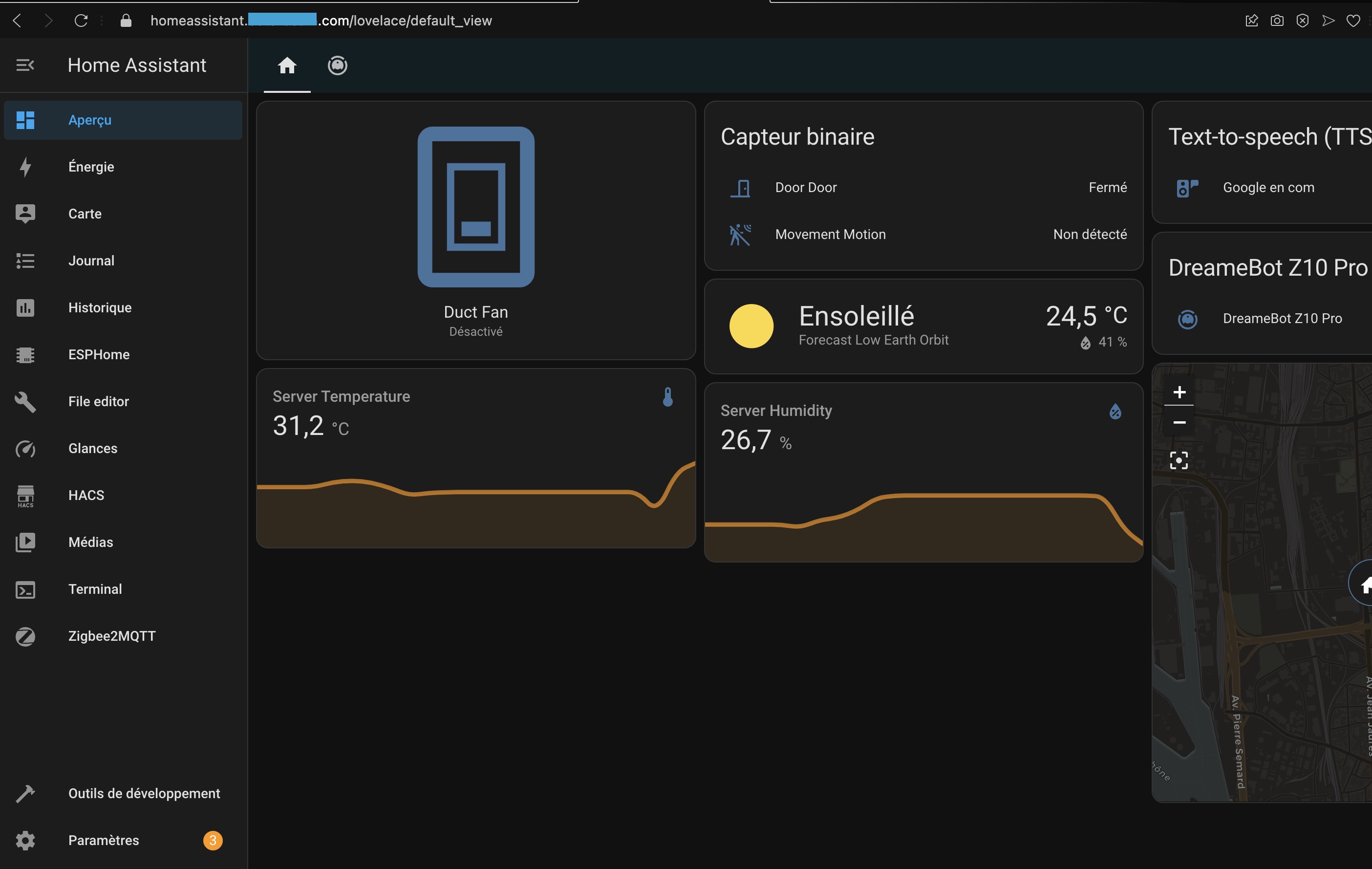

You'll just need to log on your Auth service before logging in Home Assistant. I tried from the Companion's app and it worked perfectly with Authelia.
You are now set, enjoy the automations ! 👏
