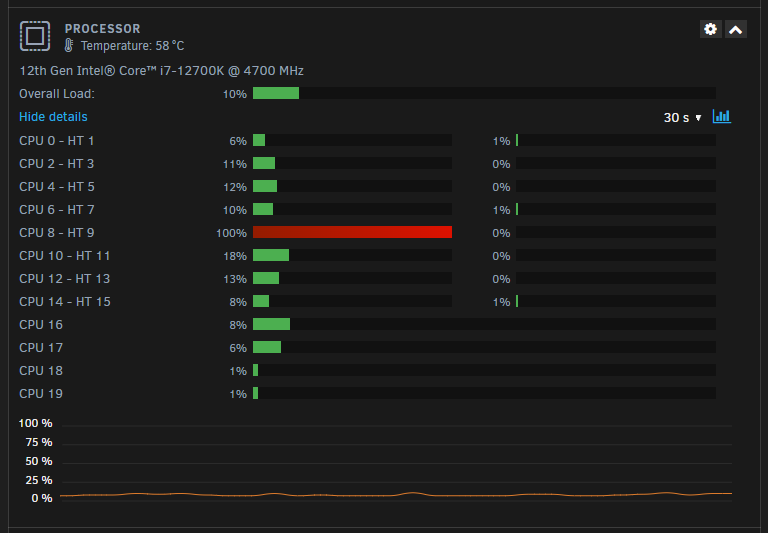

Not sure if this is connected, but I'm seeing this one core pegged for several minutes now.
....AAANNNDDD it just went unresponsive again. I think full crash this time.
Uuuggghhh, I feel sick.
