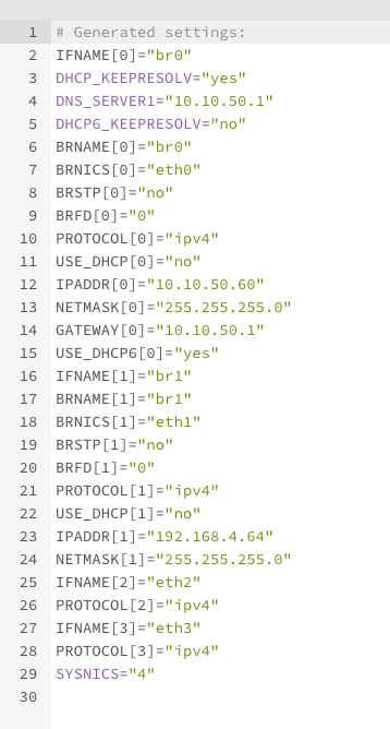

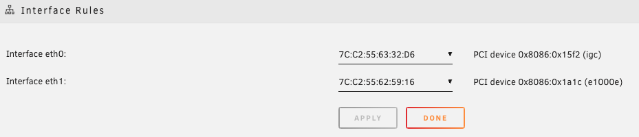

October 12, 20233 yr Network Settings. Also, the nic is visible in bios. I deleted the the network.cfg file and restarted. No change. NIC is Intel E810-XXV in "server2". Happy for any help. // kjell-diagnostics-20231012-2357.zip
October 13, 20233 yr Author 5 hours ago, JorgeB said: Try deleting network-rules.cfg and reboot. I done that, but no change. Then I moved the NIC from slot 4 to slot 7. Then I see both ports in network settings. Still somewhat puzzled about why it's not visible in slot 4. OK, no problem having the nic in slot 7. But I can't get the nic to work. One port says "check cable", the other I can't get communication going. Pretty sure the cable is ok, tested 3 different including one that worked with this nic on the former mobo. Added diagnostics after I moved the nic. kjell-diagnostics-20231013-1526.zip

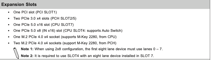

October 13, 20233 yr Author 20 minutes ago, JorgeB said: Link detected: no No link detected on the 2nd port, this is not an OS/configuration issue. I found this in the mobo manual. Note 2 is kind a strange. (If you drive in lane b, you have to drive in a). My understanding is that slot 7 only supports x16. The nic is x8, that's why I put it there in the first place. I move it back and see if I can get it in Network setting.

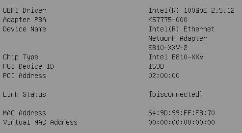

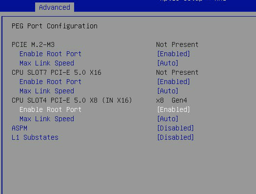

October 13, 20233 yr Author It can be on the bios level. No link. I tried disabling ASPM and changed some other setting, no luck. I´ll have a look at firmware etc. //
