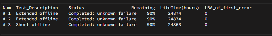

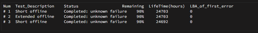

I have a couple of 8TB toshiba drives that I've had for a few years which recently started both saying there are some seek error rates in the smart report, however I'm not sure how to interpret the report. Are these just one off errors that could have been caused by a bad cable connection? Or are these drives legitimately failing and I need to put in replacements immediately? I've attached the smart reports to this post.

I can't seem to get an extended or short test to even run on either of the drives, it tries and then a few seconds later says "Completed: unknown failure".

7 hours ago, sazrocks said:
How can it go from "Failing" to "Past"?
That means it failed in the past but is not failing now.
