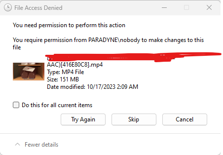

you need permission to perform this action
I keep getting these problem whenever I download from qbittorrent. The only fix i know is to run new perm but its only for short term and iwill need to run it again when new files downloaded.
Any idea how to set qbit to allow move/copy/modify files it download? Thanks.

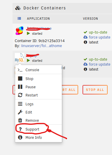

You need to go to the 'qbit' Docker, left click on its icon, select 'Edit', and look for the keys with 'PARADYNE' and 'nobody' as the editable variables.  Change them to 'nobody' and 'users'.
If this does not work, go to the support thread for this Docker and ask there.

Go here to find support thread:

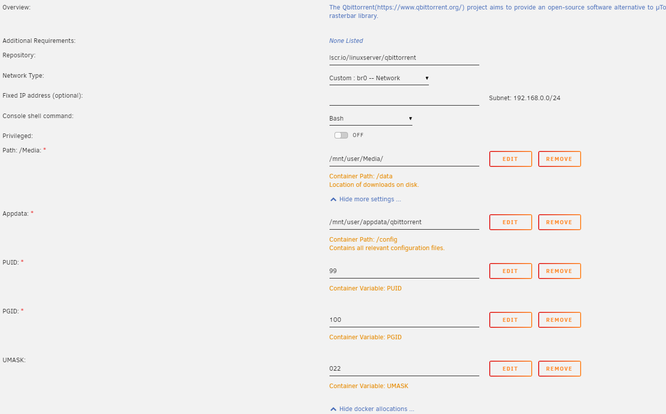

I edit all my docker qbit, sonarr, radarr and etc to UMASK 000 and now that seems to fix it.

do you have a picture of where this is? i dont have umask in my docker settings.
Edited by crazycajun
While in the Edit option of the Docker dropdown, make sure that you have clicked on the 'Show more settings' dropdown.
If it not there, go to the support link for that Docker and ask this question there.
NOTE:  Setting the UMASK variable is not required unless that directories created in the User Shares by that Docker container are not 777.  (Files should be 666.  It could be 777 but that setting is not recommended for strictly data files.)
This does not apply to any files in the   appdata   share.  That share is  intended to accessed by only Docker containers to store their files in.  A Share Access user should ever have to access   appdata   share for data!  The owner, group and permissions are set to permit the Docker container to access files for its own use.
