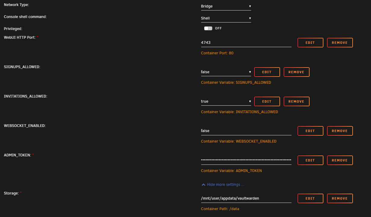

No, I dont see anything for config data - these are all the allocations I see;
I am not familiar with vaultwarden and t is possible everything is stored under the /data location within the container, but this is slightly unusual as for mist containers there is a separate location where configuration information is stored.   You might want to check as otherwise this information is being stored internally within the container inside the docker.img file whereas you really want it stored externally on the host.
