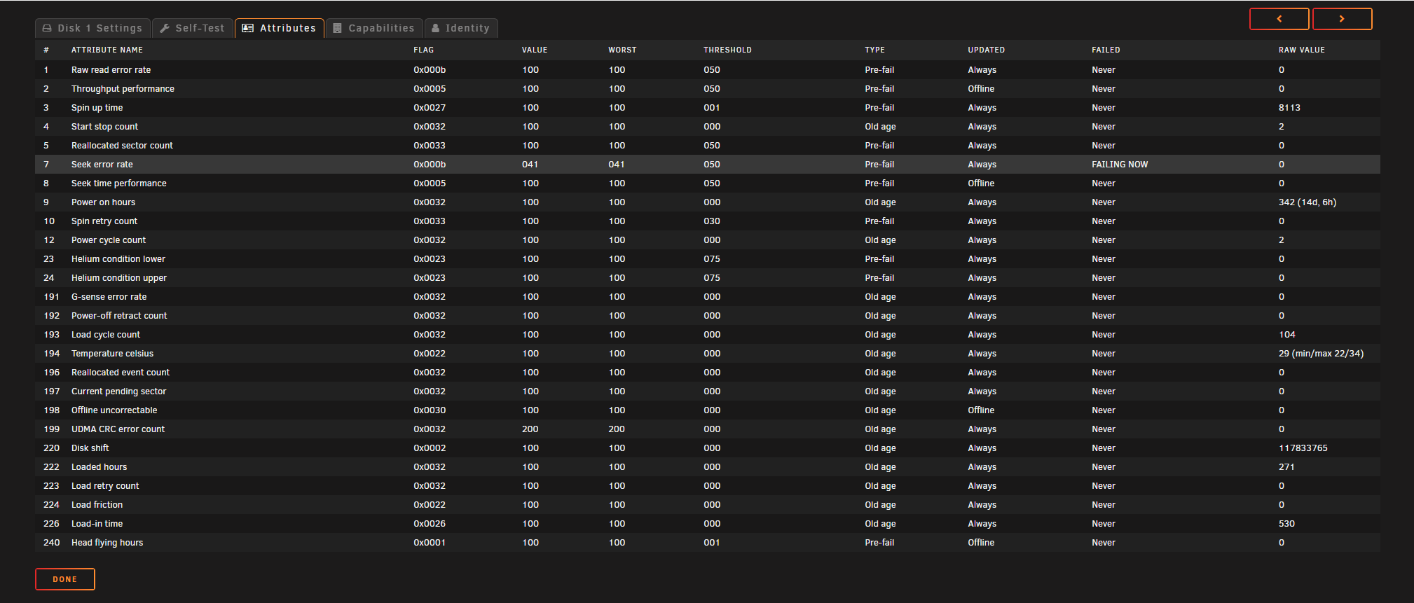

Unraid's just flagged up that Disk 1 (which is only 2 weeks old) has a SEEK_ERROR_RATE issue with the status FAILING NOW.
What does this mean? And what should I do with the Data on that disc?
A seek error happens when heads are unable to locate the data.  Could be mechanical or misalignment, but being the drive is new, I would warranty replace it.

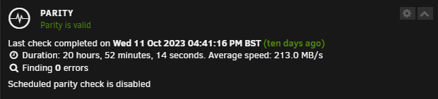

Thanks for the advice - last Parity Check was 10 days ago, should I rerun the check before removing the drive?
In terms of moving the data for redundancy, is it just a case of manuall moving everything from /mnt/disk1 to /mnt/disk2 or am I missing something here?
I wouldn't.  Just replace and rebuild the disk.

This has become an issue again. Im now on my THIRD drive! All drives fail in Disk 1.
Drive 1 - Seek Error Rate of less than 30. RMA'd and replaced with new device.
Drive 2 - Seek Error Rate of less than 40. RMA's again and replaced with another new device.
Drive 3 - Been in overnight and Seek Error currently at 92 and dropping, even with no data being used/pulled from the Array.
I'm losing my marbles! @JorgeB I heard you run lots of Toshibas. Any thoughts?
I just cant understand why its always Disk 1 thats failing and not my Parity or Disk 2.
The Seek error rate failing now attribute seems to be a common issue with some Toshiba models, possibly a firmware problem, the error usually goes away on its own, probably not worth replacing the disk just for that.
