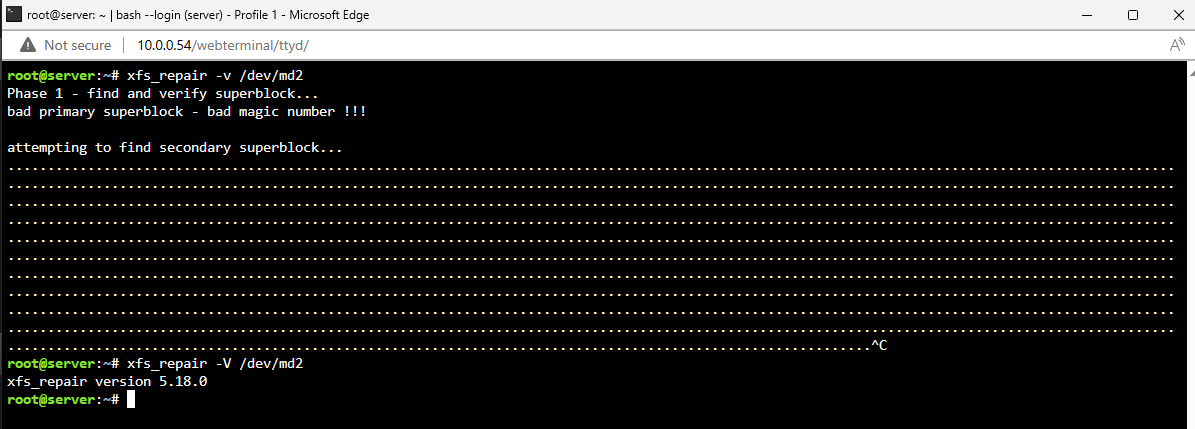

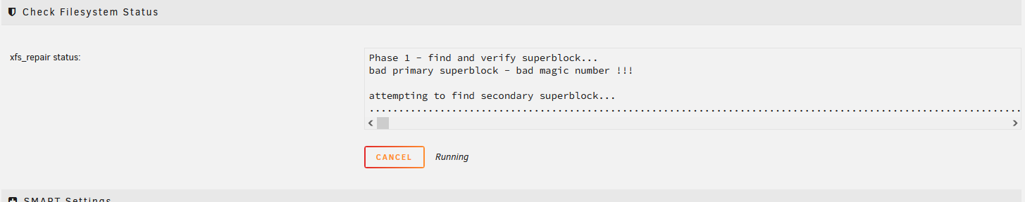

From the GUI, I've done this before and it just shows this with an exit message after running a while.
Also tried to run in terminal with Upper and lowercase "V".  Similar result and I'm not noticing any changes at this time.

That's not very surprising since blkid doesn't show a filesystem but wanted to double check, if you have a backup use it to restore the data, if you don't something like UFS explorer may be able to recover some data, there's a free trial that show allow to see if any data is recoverable or not.
So no chance of fixing the existing?
Can't think of anything else other than the options mentioned above.
