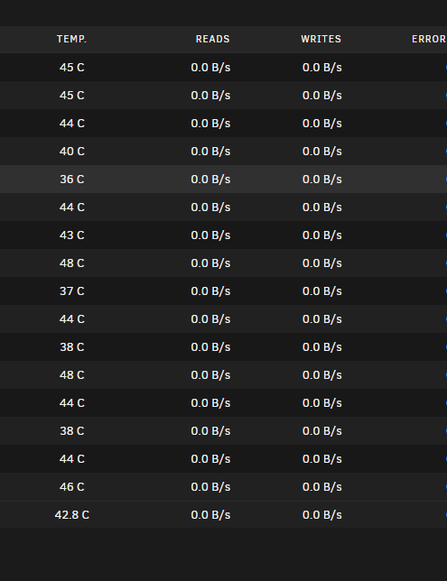

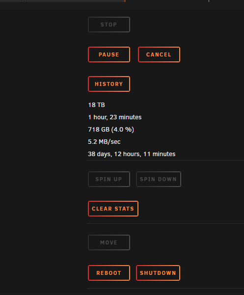

Well looking at the Segfault errors, they state its for Radarr, which is a concern, but my main issue right now is it slowing down majorly on trying to do a data rebuild.  It doesnt do anything anymore.
image.png.184f661968fc0592749076133894a6c0.pngimage.png.d2ce09dcb9c06a2d8e056d37550677fe.png
