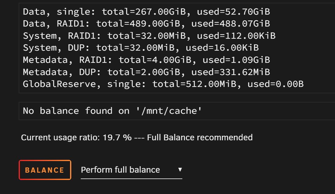

It rebalanced, I still noticed the first line still said RAID1. I set it to Convert to single and it runs, but then it says I should Balance again... it's like in a loop.
tower-diagnostics-20231027-2200.zip
This is what I get after running "convert to single mode"
Edited by dimitriz
Looks like the balance is failing due to the existing corruption from the device dropping earlier, suggest backing up what you can and re-format the pool.
