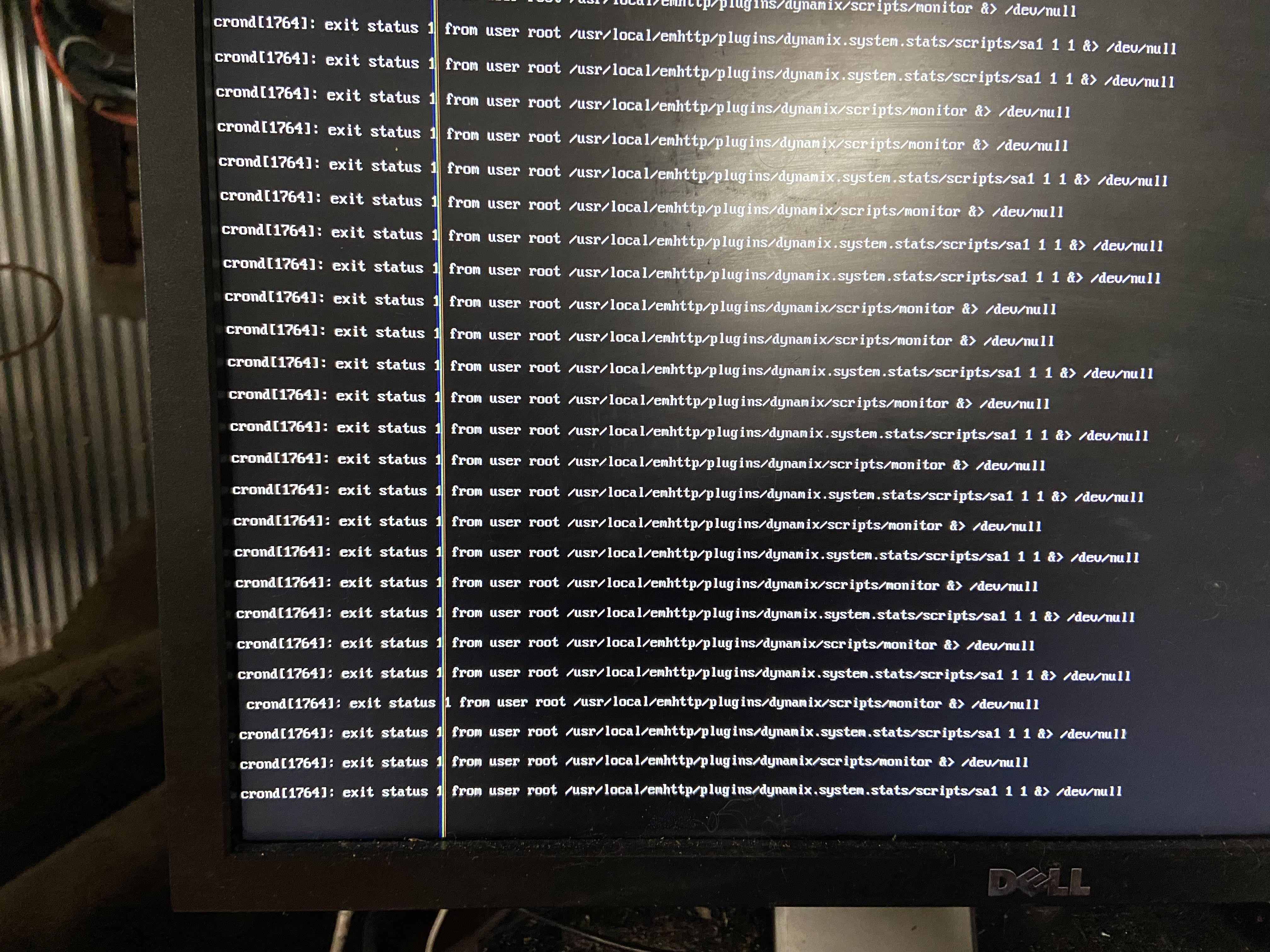

Attached is my syslog...this was started on 10/25/23 after a crash I experienced earlier in that day.  The snipet above from from line 126 to line 746.   Then after line 746 was the reboot.  I took a picture of my monitor when the system was crashed....see below.  Obviously with the crash being random, I am unable to run and capture a diagnostic that covers the crash event...so I ran one right now for your reference and attached it.

If you usually see these before the crash try booting in safe mode and/or closing any browser windows open to the GUI, only open when you need to use it then close again.
