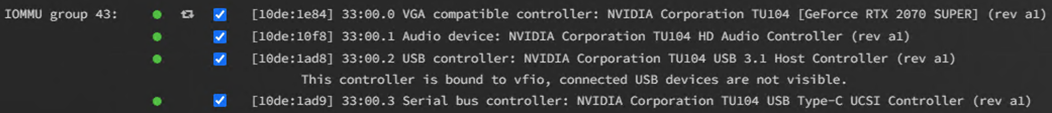

October 28, 20233 yr I have an issue that has been present I believe with every 6.12.x release. My Windows VM will not start properly unless its first shut down using a Force Stop command. Restarting reboots the VM, but it will not start properly. Graceful shutdown then restarting boots the VM but it does not start properly. There is zero information in the logs. This VM does use one of my graphics cards that is passed through. The only thing I noticed is when I plug in a monitor to see whats going on, the times it doesnt boot properly I see a big unraid logo then the screen goes black. When it does work properly after a Force Stop and restart it goes straight to a Windows spinner icon and loads up just fine. Any idea what could be causing this? Its really annoying and I'm not comfortable always force stopping the VM. It makes Windows updates very nerve racking. Edited October 28, 20233 yr by johnsanc
November 2, 20233 yr Seems like the gpu is not properly isolated and as soon you restart or shoutdown the vm the host is using it without releasing it properly on the next vm boot.
November 2, 20233 yr Author Any pointers on how to properly isolate it? I have it bound here: and vfio-pci.cfg: BIND=0000:2f:00.1|1022:149c 0000:2f:00.3|1022:149c 0000:33:00.0|10de:1e84 0000:33:00.1|10de:10f8 0000:33:00.2|10de:1ad8 0000:33:00.3|10de:1ad9 Long ago I had something in my go file... do I need to do something there?
