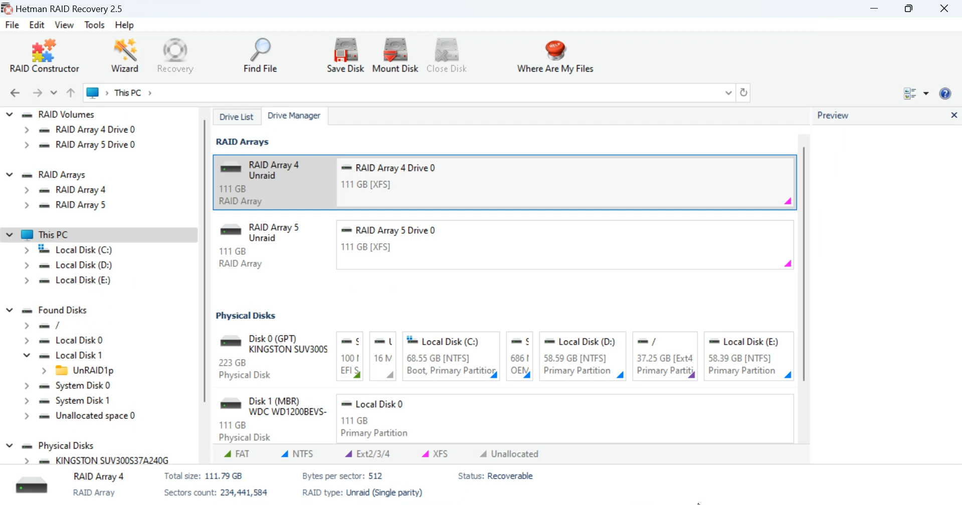

The method described in this article looks logical and correct. But I could not restore the system.
As my array was created with one parity disk, the information is stored in its original form on two another disks.
I take the disks out of Unraid OS storage system and connect them to a Windows computer.
Installed Hetman RAID Recovery and ran the raid constructor in it.
When I gave all the parameters I know, I saw the preview of my array. I scan and unfold it, program show its folders .
this is what it looks like:
Don't know anything about that. The array data disks in Unraid are readable individually on any Linux, since they are not really a RAID volume.
