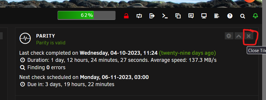

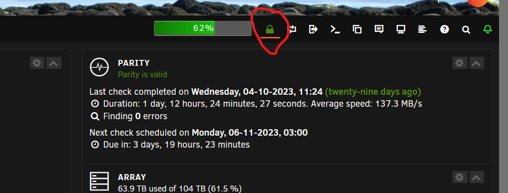

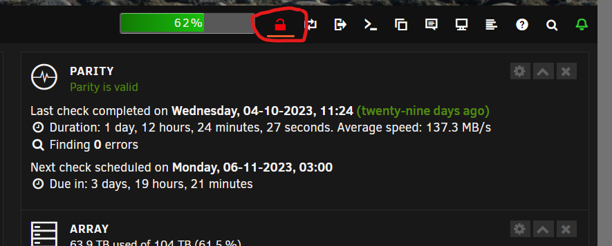

November 2, 20233 yr 1 hour ago, wbgwwd said: The docker and vms tiles in the unraid 6.12.4 dashboard are turned off, to take them out how do I take them out? Placed it there in the display settings to no avail. Can that guru help me? Hi, I am not 100% sure to understand your question. If you want to remove tiles from the Dashboard, you should : 1. unlock the tiles 2. then close the tiles you do not need (you can take the opportunity to move tiles to suit your needs) 3. optionally, I would advise to lock the dashboard again (so it is back to green) If I misunderstood, please clarify your question.

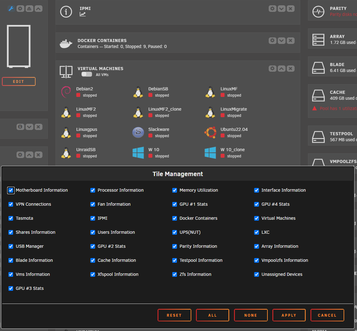

November 4, 20233 yr 2 hours ago, wbgwwd said: I am trying to restore tiles that have been deleted, such as docker. Unlock the page, then a spanner will show on system info panel click on it and the panel settings popup will show.
