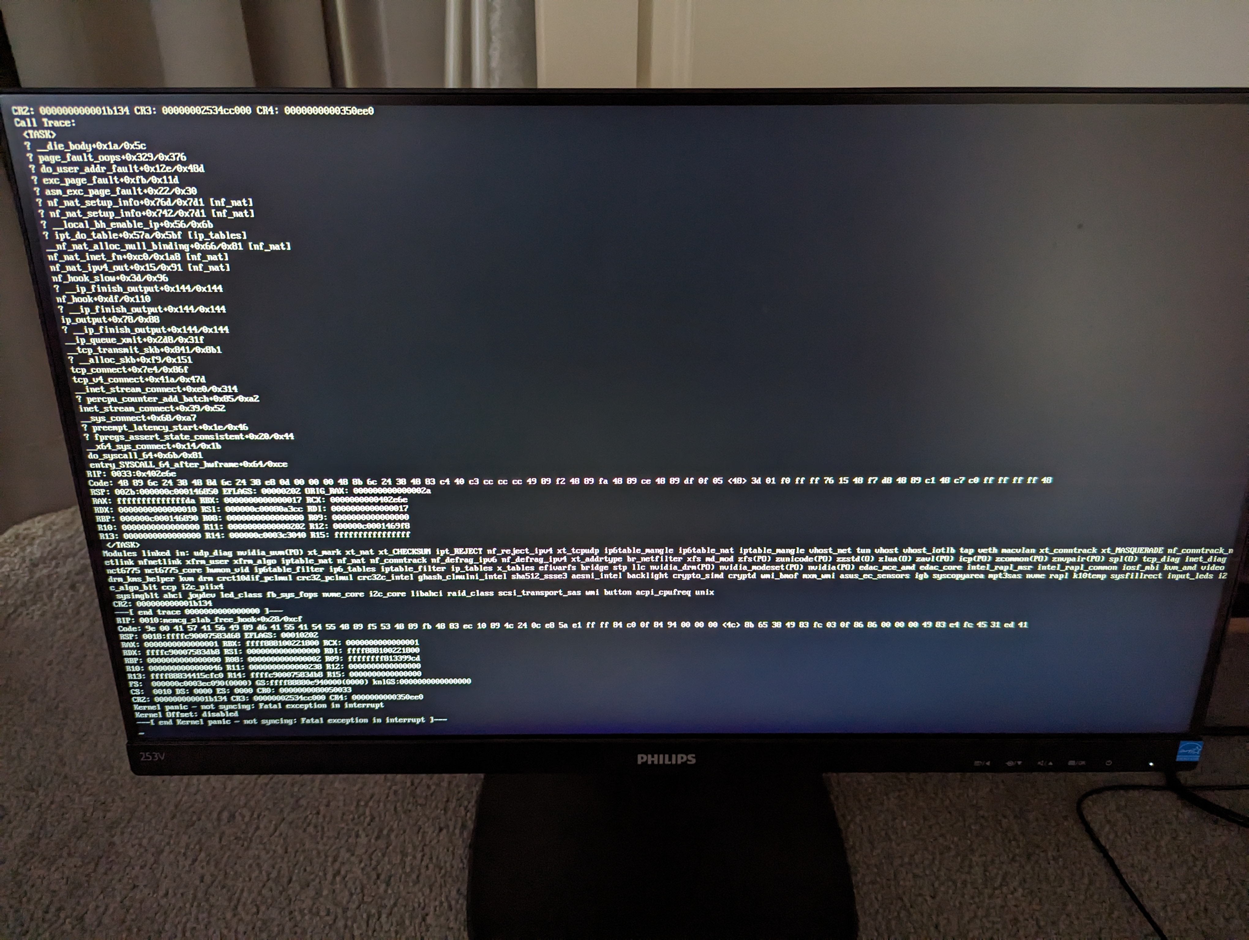

Hi all, my UNRAID server keeps crashing everyday and I have no clue why!
I was able to take a picture of some sort of crash report (see image). Does anyone know what might be causing this issue?
Please let me know of anything that would help to fix this issue.

Switching to ipvlan should fix it (Settings -> Docker Settings -> Docker custom network type -> ipvlan (advanced view must be enabled, top right)).

It's a known issue, and in the screenshot you posted looks like there's a call trace related to that.
