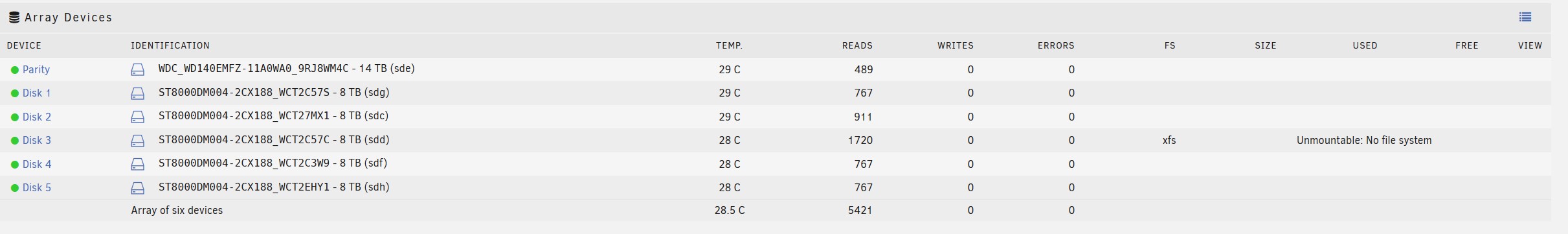

Hi, hoping someone can help me out with this. My Unraid system seems to have developed a problem. System was working fine at last shutdown, had a power cut while the system was shut down but still plugged in, and now I've got this fault on Disk 3 "Unmountable: No file system" Not sure if the power cut caused it, don't know how as it wasn't running at the time, but it's the only thing that has happened since last shutdown. I've included a copy of the Syslog as well as the results of a Check Filesystem Status check (I've "x" some of the file names as they contain personal info).
Can I simply repair in situ or do I need to pull and replace the drive, then rebuild via parity? Hoping for the former rather than the latter tbh.

Run xfs_repair again without -n or nothing will be done.

Comes back with this
"Phase 1 - find and verify superblock...
Phase 2 - using internal log
        - zero log...
Log inconsistent (didn't find previous header)
failed to find log head
zero_log: cannot find log head/tail (xlog_find_tail=5)
ERROR: The log head and/or tail cannot be discovered. Attempt to mount the
filesystem to replay the log or use the -L option to destroy the log and
attempt a repair."
