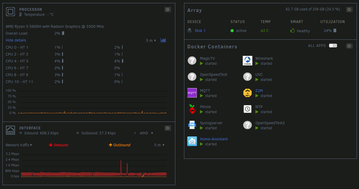

I use Morefine S500 minipc, with 64G RAM, two M2, and two LAN to host docker only, use for home automation, CCTV and TV recording, it serve me several month well.
To summarize
. Docker size only ~6GB, I put them to ram disk.
. CCTV ~12GB for three day, also store in ram disk and finally archived to M2.
. The 2TB M2 is the storage for all, other 256GB M2 was for backup purpose, to backup appdata, Unraid USB image etc.
. Zigbee USB dongle to connect Zigbee device.
Really compact and power efficient ~20w, no need build/DIY.
