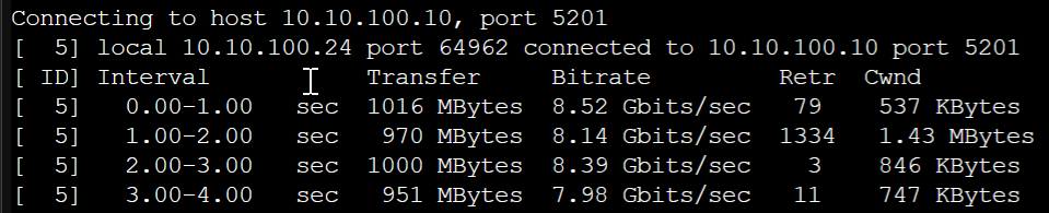

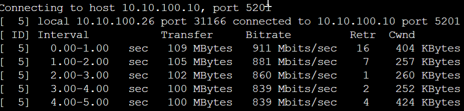

IPerf3 from the 3 Clients:
LinuxClient1:
LinuxClient2:

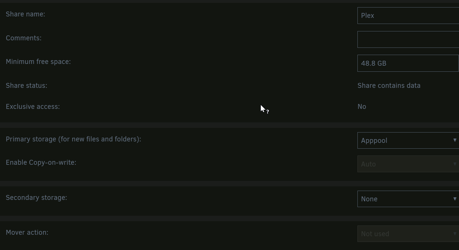

and just to verify that the share /mnt/user/Plex is using only the cache:

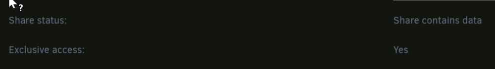

Can you try SMB with a Linux client? Also try writing to an exclusive share (or disk share).
From LinuxClient 1 mounted the Plex share via SMB. Noticed that my Plex share was not Exclusive because the NFS export was enabled, I did not realize that was a requirement. Running FIO looks much better now:
Trying from Linux Client 2, since we should now be able to saturate the 1GB link.
So it seems that the issue is when not having Exclusive shares enabled. So this is fine for data that writes directly to cache pools, as I have no issues running exclusive shares. But for actual write cache for the array that mover runs on, is there a way to improve the performance there or is something else I have bottlenecking that cache? For example, I've been planning on running a Pool of 2 SSDs striped for improving write performance to the array and then having the mover run at night, is it possible to get better than the 50MB/s-90MB/s writes that I was seeing without exclusive shares?
