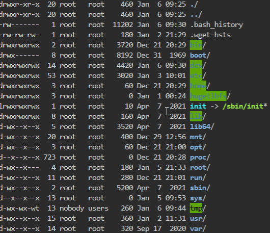

  7. Looks like that worked, rebooted and so far no issues. Thank you!
