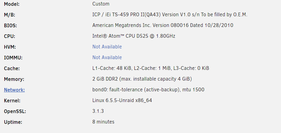

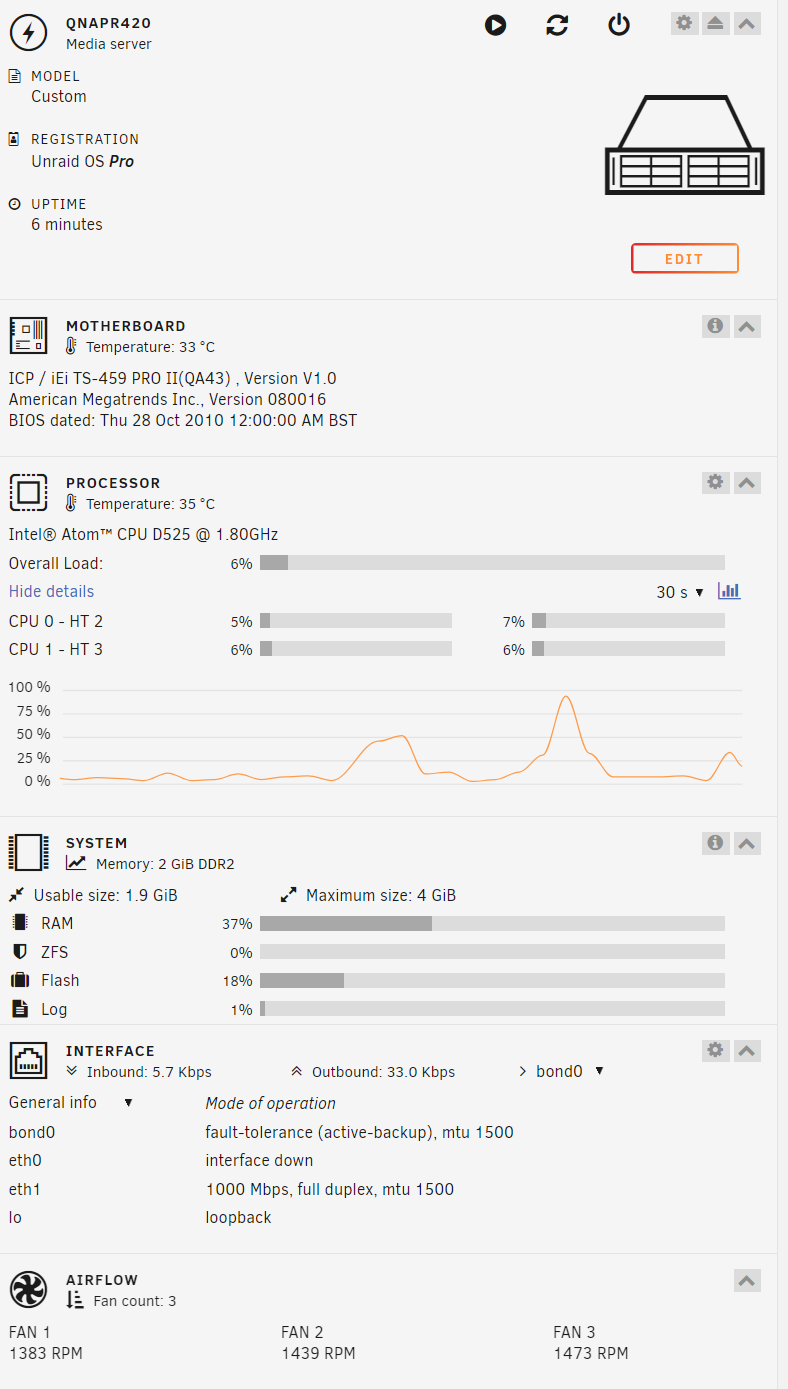

I have a test QNAP for testing, its not setup correctly on the QNAP as I moved the flash to a DELL test server so the disks dont match so the array is not started. But its does boot and run in 2Gb. Create a trial usb and boot. This is my hardware.

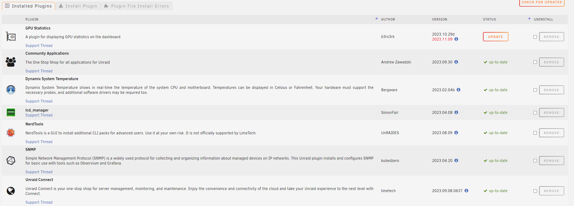

Also I have a plugin to support LCDs on qnap.
