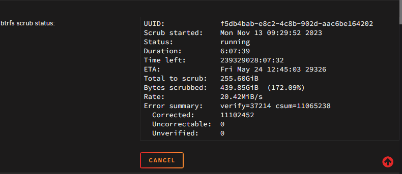

Starting to see some strange things going on with it.  Is this ok?
I think that fixed me up sir.  Thank you so much for your help.

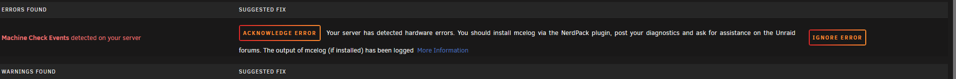

So....it happened again.  Guessing I might have an issue with that drive?  I was able to recover it the same as before, but this is popping up now.  And I'm not seeing that plugin in the nerdtools pack.
unraid-diagnostics-20231118-0842.zip
Assuming the stats were reset the device dropped offline again:
Nov 16 21:50:23 Unraid kernel: BTRFS info (device sdb1): bdev /dev/sdb1 errs: wr 92704976, rd 33512, flush 67810, corrupt 0, gen 0
If you haven't yet replace both cables, if it keeps dropping replace the device.
