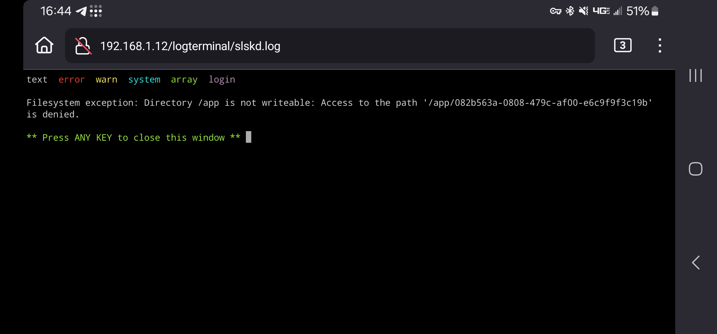

  1. Hey Chaz, if you are still around some, do you think you could point me in the right direction to use multiple folders with this script? I keep running in to errors and I'm not sure where I'm going wrong. Thanks!
  2. Getting this error when I add the user flag. If I take the tag back out, it functions fine.
