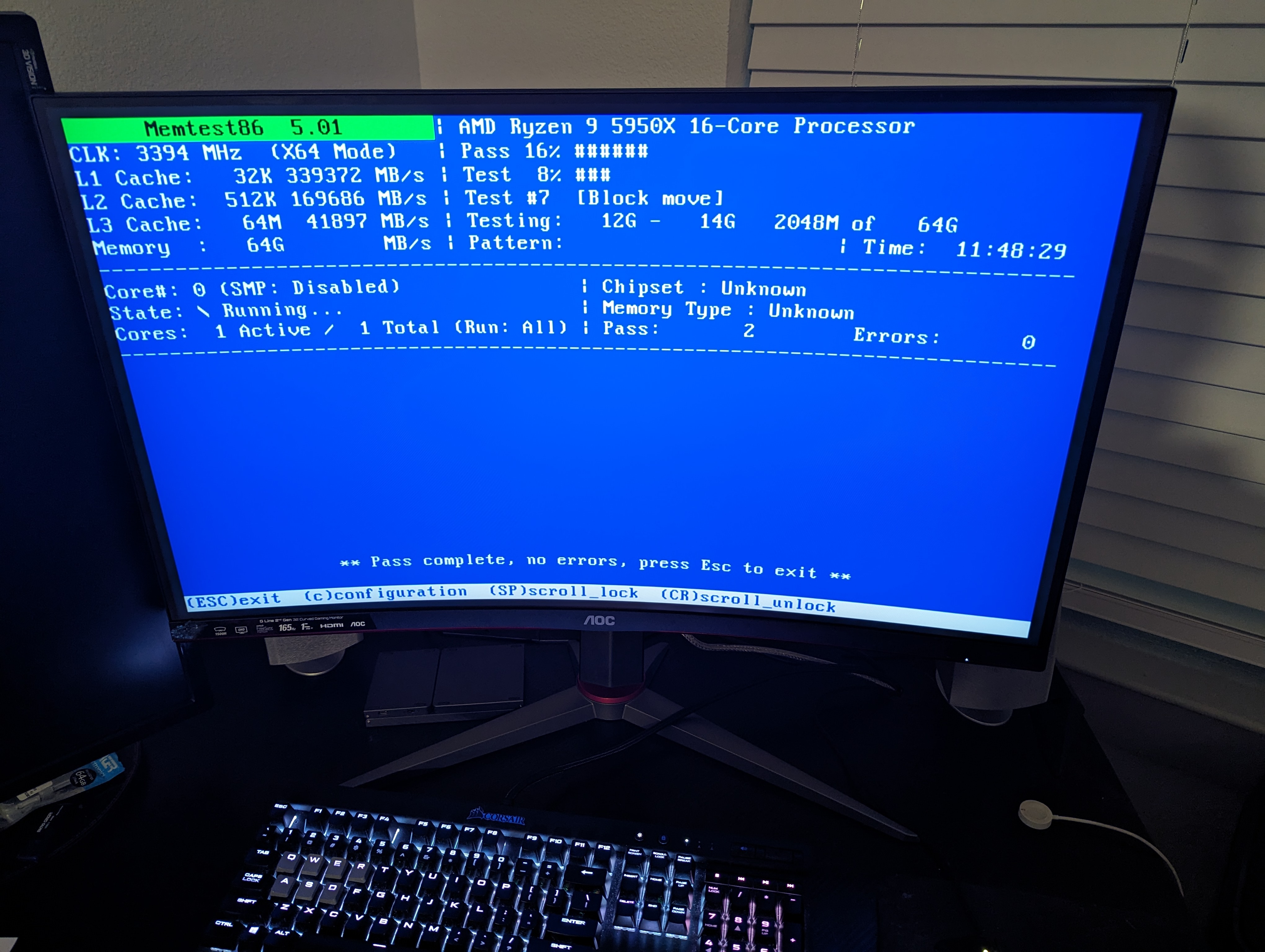

I been using unraid for about a year or two now, and after upgrading my ram to 64GB I have been having an error where my whole system would crash and then reboot immediately after about 20 hours or so of being on consistently.
I also have the "Machine Check Events detected on your server" error on my system as well. Not sure how to fix this either.
I have attached a copy of my diagnostics file. So I'm just not sure where to start to fix the problem outside of running the ram test. Which I ran for an hour and a half and had zero errors.

1 hour and a half for memtest is not much, but you can also try removing the extra RAM and se if the server returns to stable.

I have the test running currently while I go off to work, so hopefully after 9 hours I see some different results

Update, so after running the ram test for 11 hours with no errors I decided to open up my case and double check if everything was plugged in correctly, double check my bios and even move the ram to the other 2 slots on my motherboard. Upon opening my case I noticed that I had one pcie cable split into two 8 pin connections plugged into my rtx 3080 gpu at once. Which I think caused the random reboots because the GPU was not getting enough power. Once I plugged the rtx 3080 into different 8 pin cables, I have been running my system for 11 hours no errors ( it was crashing once every 6-7 hours )with both ram sticks in. So i will mark this as solved and chalk it up to user setup error. due to GPU pins lol.
