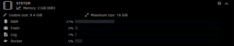

Yesterday I installed unraid (Version: 6.12.4) on my terramaster F2-221 (2-bay, Intel J3355 2.0ghz, 2gb ram) and added an extra 8gb stick of ram (10gb total). I put one drive (12TB) as parity and one 12TB as the array.
I installed 2 docker containers: Omada controller and Plex Media Server. No cache, installed on mnt/user/appdata.
Someone was watching a plex stream in my house as I was transferring ~700gb to the array from my networked windows PC. About 600gb into the transfer I got an error stating "not enough memory" and the file transfer stopped and I had to "skip all" the rest of the files (forgot to screenshot the exact error). I did a ~1TB transfer overnight with no issues, so I'm assuming it has to do with the plex stream running.
I had my server dashboard open and ram usage was 27%. I think I only have ~2tb/12tb on it right now so lots of storage space left.
Looking at my dashboard I'm wondering if the system can only access 2gb of the 10? It says "System - Memory: 2 GiB", and below it usable size 9.4GB. It never seems to go above 27% usage though, so that's why I think the system is not able to access the full 10gb and that's what led to the error.

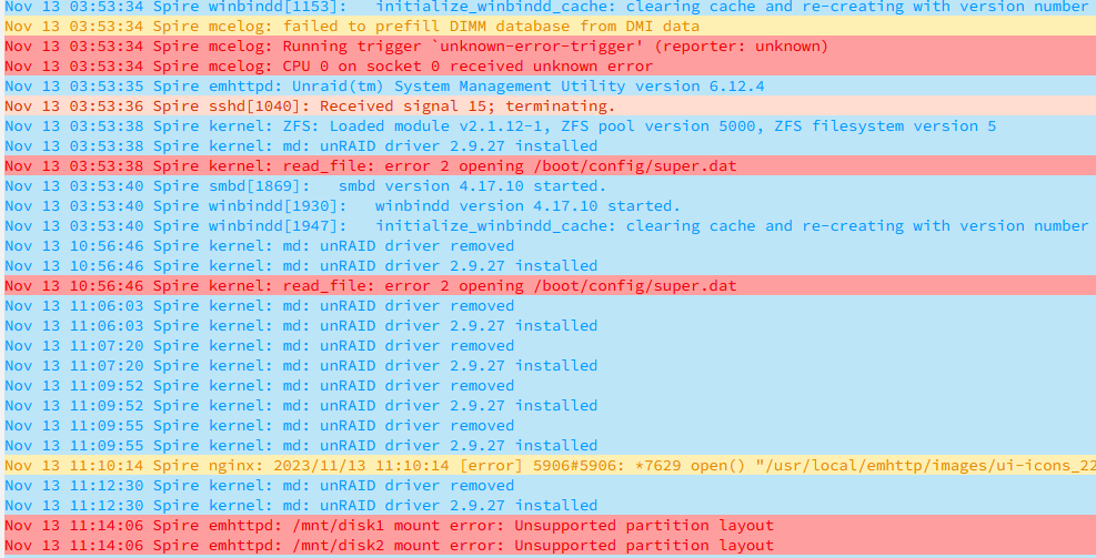

mcelog errors around the time the transfer are attached.

It's not the RAM, it's using 9.4GB.
Thank you! Something is definitely going wrong. I ended up installing the fix common problems tool and a machine check event error detected hardware errors and is asking me to post here with my diagnostics for assistance. Any help is appreciated, thank you!
You can post them, but not always clear what the hardware problem is just by looking at the diags.
I might be doing this wrong - just running diagnostics under tools and downloading that. If it's a different one I'm supposed to be running please let me know.
spire-diagnostics-20231116-0931.zip
Nov 15 19:38:19 Spire mcelog: CPU 0 on socket 0 received unknown error
Nov 15 19:38:19 Spire mcelog: Location: CPU 0 on socket 0
Possibly a CPU problem.
Hm. My HDD are getting pretty hot ~60 degrees without an external floor fan pointing at the nas, so I wonder if the CPU is overheating under long load times. I was wondering if I could get away with this old Terramaster, looks like probably not. I have a full size PC, will just move everything over to that and ditch the little nas box. Ty.
