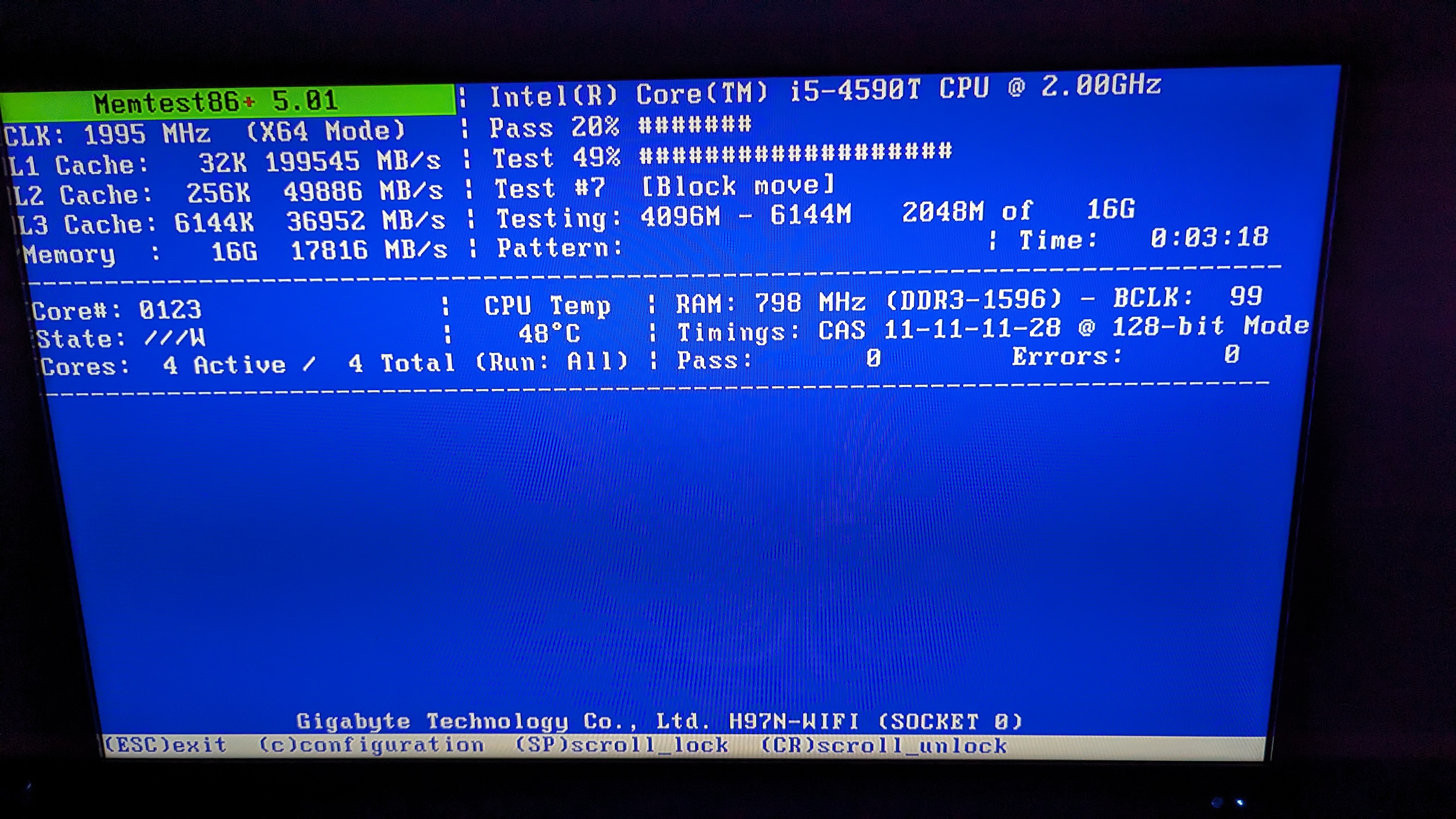

I've had memtest freeze on my once (screenshot attached) but since I restarted it, it's completed 1 pass against all CPU cores with 0 errors. It's just over half way through the 2nd again.
I swapped the 2x RAM sticks approx 2 months ago when it 1st staretd crashing and it seemed to be fine for a month until it started again. I'm starting to think it's either the board or the CPU now (both are now 10yrs old and been running 24/7 for probably 8yrs)
memtest passed twice with no errors.

10 hours ago, opticon said:
I swapped to ZFS pools about a month ago because BTFRS was giving me corruption issues because of the server crashes
If you are having issues with both btrfs and zfs it basically confirms to me that you have a hardware problem, if it's not RAM it could be CPU or board.
Bugger! Thanks for the advice

9 hours ago, opticon said:
this looks to be network hardware or driver related?
Change the docker network from macvlan to ipvlan and reboot.
I need to use macvlan as I've got multiple networks
You can still use macvlan with v6.12.4 as long as bridging is disabled, see the release notes.
  • 2 months later...
For anyone having this issue, check this "fix" i did. Im using ipvlan as well.
