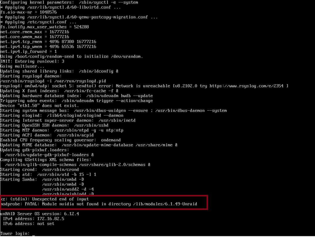

 Got this after a normal reboot
modprobe: FATAL : Module nvidia not found in directory /lib/module/6.1.49-Unraid
Edit: I uninstalled several plugins and downgraded the Nvidia plugin. After restarting, I no longer see nvidia error in the log, but the Dashboard still isn't loading.
