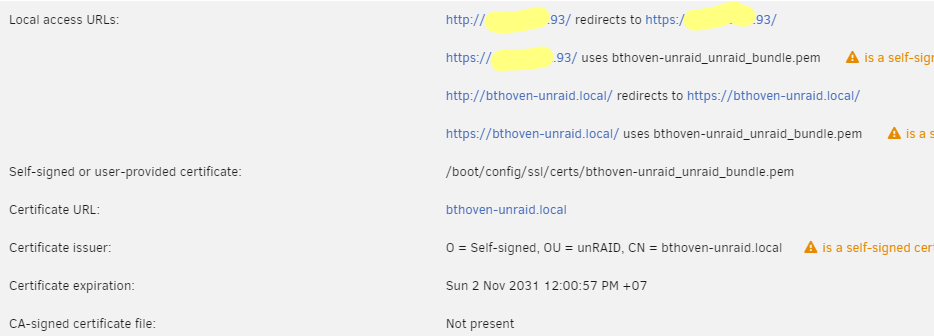

From the Settings/Management Access, unraid already created a self-signed certificate (without CA) for my local domain, for me, bthoven-unraid.local. Yours are different.
My objective is to get rid of the privacy error when opening the webui with the above local domain.
The concept is for self-certificate without CA certificate, we can use its own certificate part as a CA certificate which can be imported to your webbrowser CA trusted certificate authority. The self-signed cert my unraid has created is stored at a file inside this folder
/boot/config/ssl/certs/bthoven-unraid_unraid_bundle.pem.

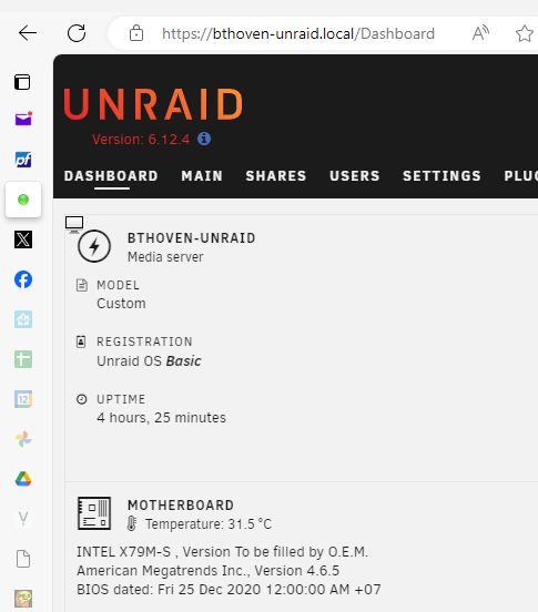

2. Inside my Microsoft Edge browser, import the cert-only file, created on step 1, into the Trusted Root Certification Authorities. Different browser has different way to do it. This step is to make your PC and all browsers on that PC "trust" unraid self-signed certificate.
3. Try entering url, in my case, bthoven-unraid.local, in your browser, the privacy error will be no longer there. In case you still get the privacy error, you may have to restart your browser, or even your PC. When I did this on my PC, it just works right away; but on my laptop, I need to restart my laptop.
