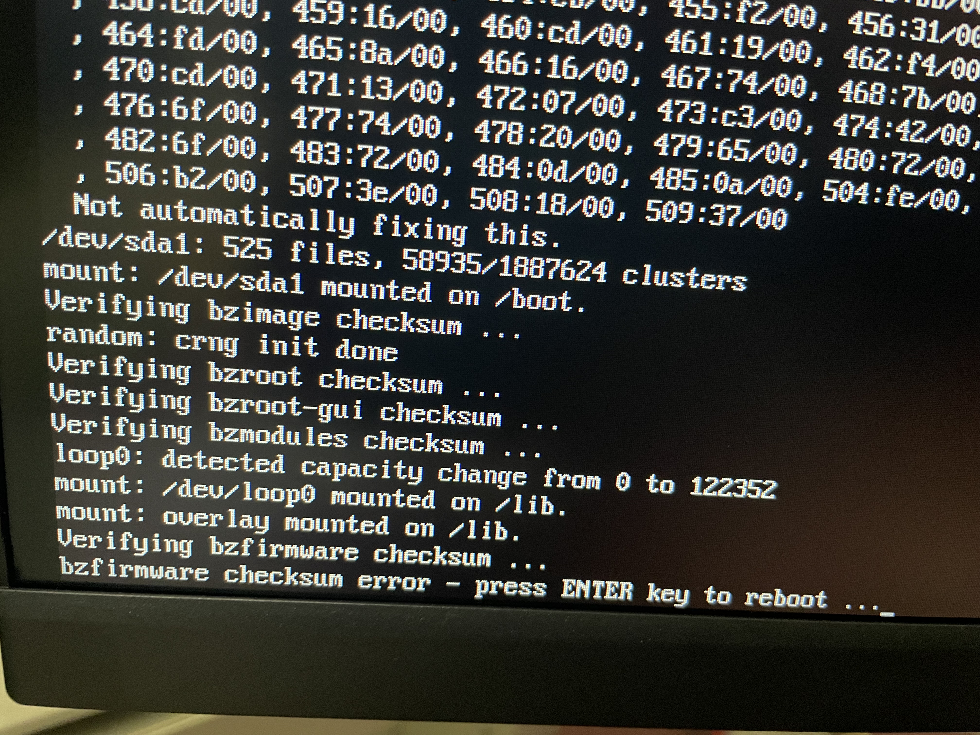

when after MB boot,into unraid start up,stuck at first GUI
use reboot SW to reboot,show:bzfirmware checksum error - press enter key to reboot
press enter,then automatic reboot,at this time,i can successfully boot up

The error suggest a problem reading the file specified off the flash drive.   I would recommend rewriting all the bz* type files on the flash drive as described here in the online documentation accessible via the ‘Manual’ link at the bottom of the GUI or the DOCS link at the top of each forum page.
so,is my flash drive broken?
Not necessarily.   As that link mentions rewriting the bz* files frequently fixes the issue and you then exhibit no further problems.

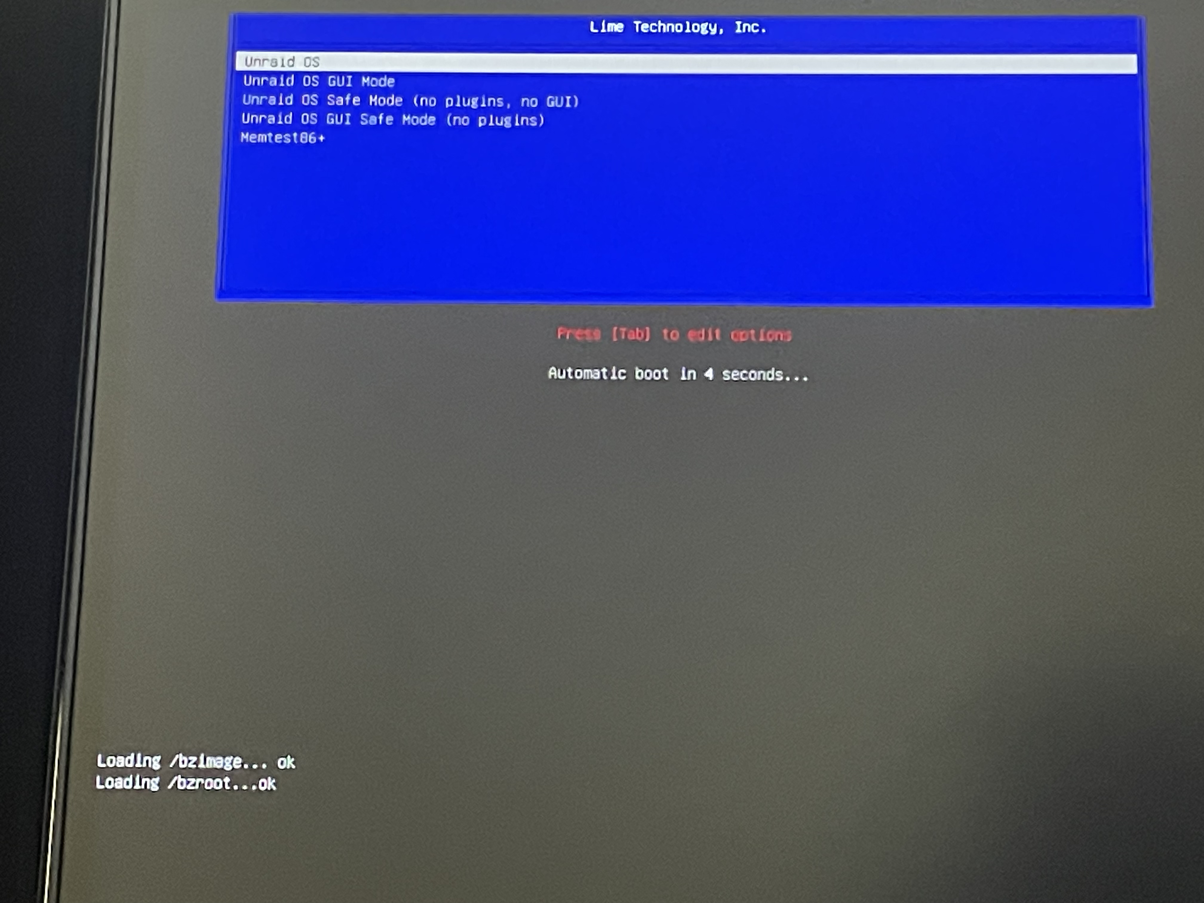

this days ,when I want start my system,require boot four times
first time,after MB self test,stuck,display nothing,keyboard not response,then I MANUAL reboot
second time,after show bzroot ... ok,stuck at select boot Options interface,MANUAL reboot again
third time,display: bzfirmware checksum error - press enter key to reboot, MANUAL reboot again
fourth time,finally,boot successfully。
so,I don't know what happening
if I shutdown my computer at second or third time for 2 or 3 minute,It back to Original status,I had do it from beginning
please help me!be grateful!
