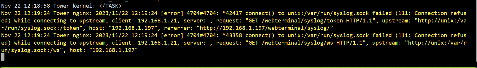

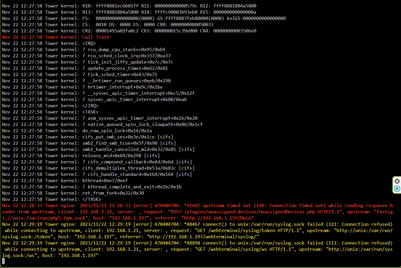

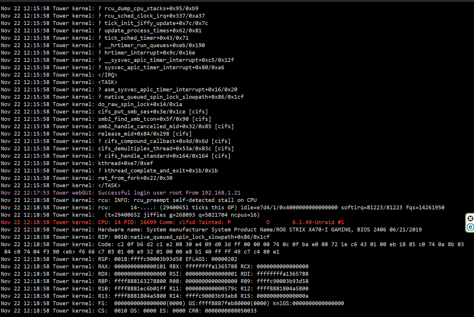

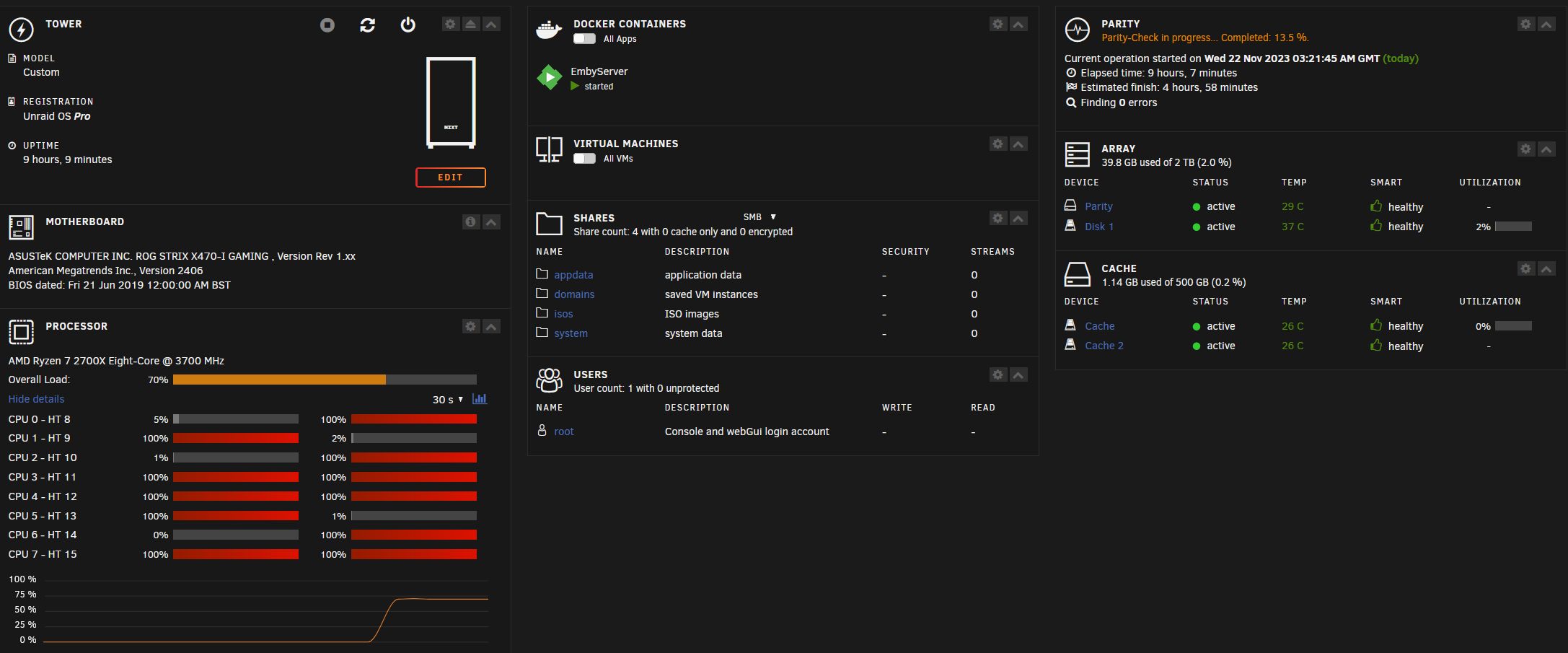

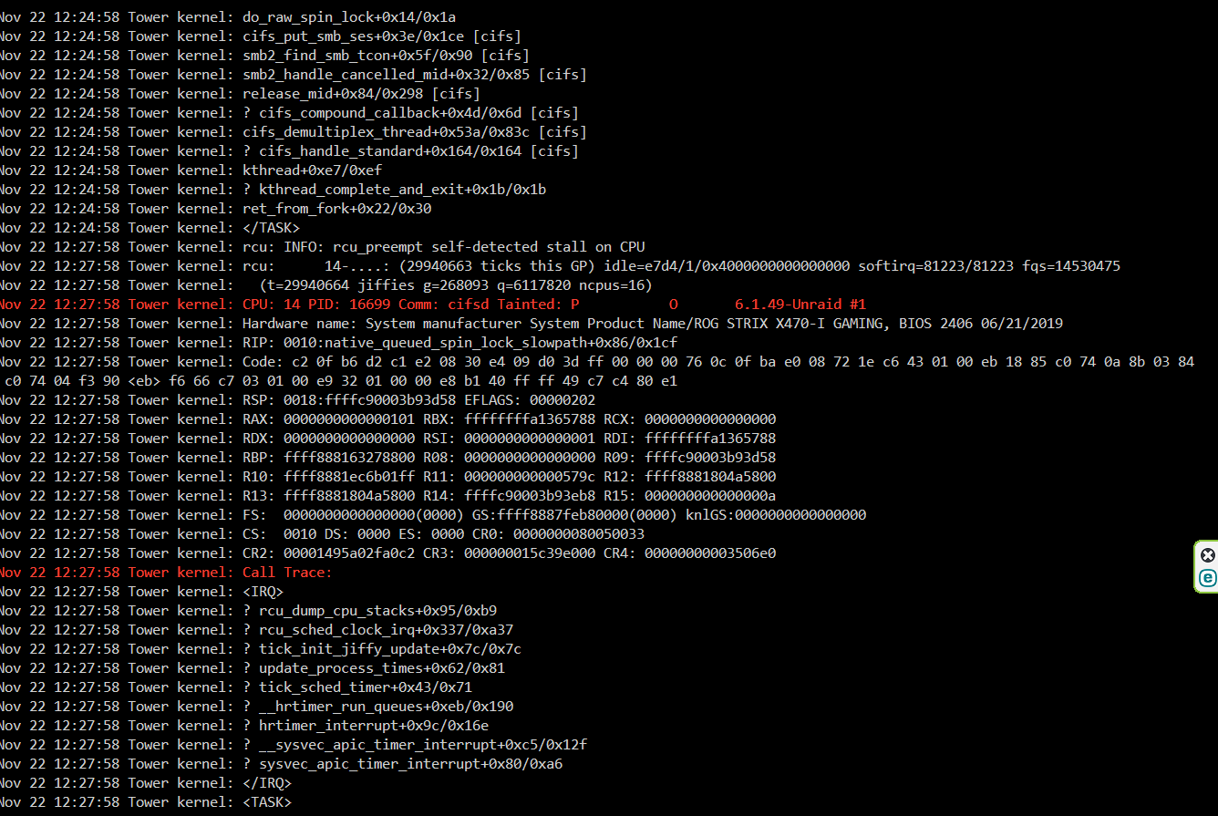

I've been running unraid pro for a few months now to host an emby server. I am using my 3070ti to do the transcoding. The cpu is currently redlining and im getting this error in the log files.
Tower Kernel: CPU: 14 PID: 16699 Comm: cifsd Tainted: P         O          6.1.49-unraid 1

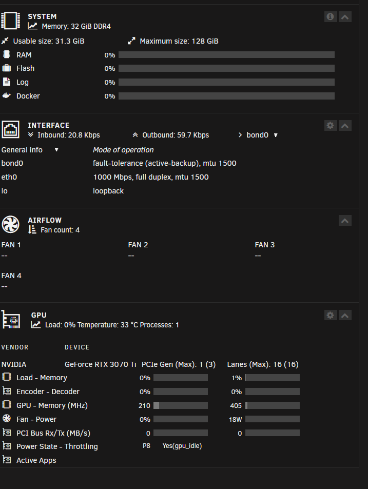

Spec is a Ryzen 2700x
32gb ram
rtx 3070ti
two 500gb cache ssd drives
i think a 2tb standard hdd

Take a look here, Ryzen with overclocked RAM like you have is known to have stability and data corruption issues.
Hi fellas,
Right, ive put the ram to the suggested speed and changed the idle setting...
