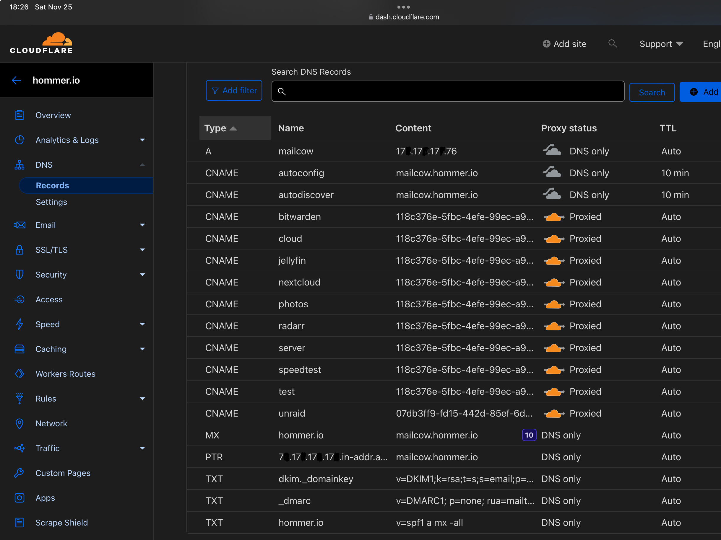

I set up a mailcow mail server and while I can send mail (and the recipient actually receives it), I am unable to receive mail. I was hesitant to attempt hosting my own email server due to all the negativity surrounding it. It was relatively easy to get to this point but I don’t understand how to solve this issue. I attached a screenshot of my dns records if anyone sees a problem let me know.
