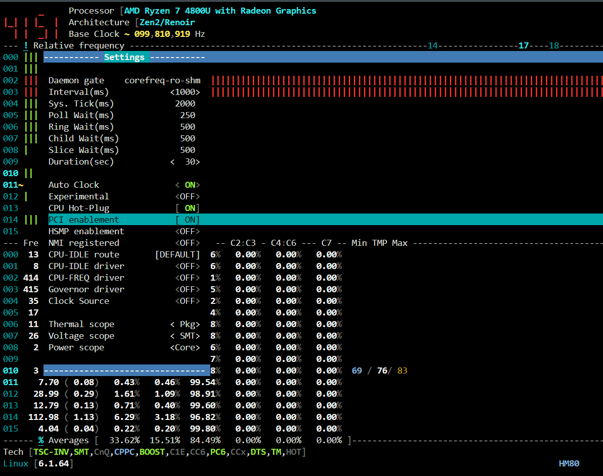

I installed CoreFreq but don't know where I could limit the TDP.

Temperature looks pretty high, with a minimum of 69C. Show me what is the "CPU-Idle driver" in the "Kernel" window

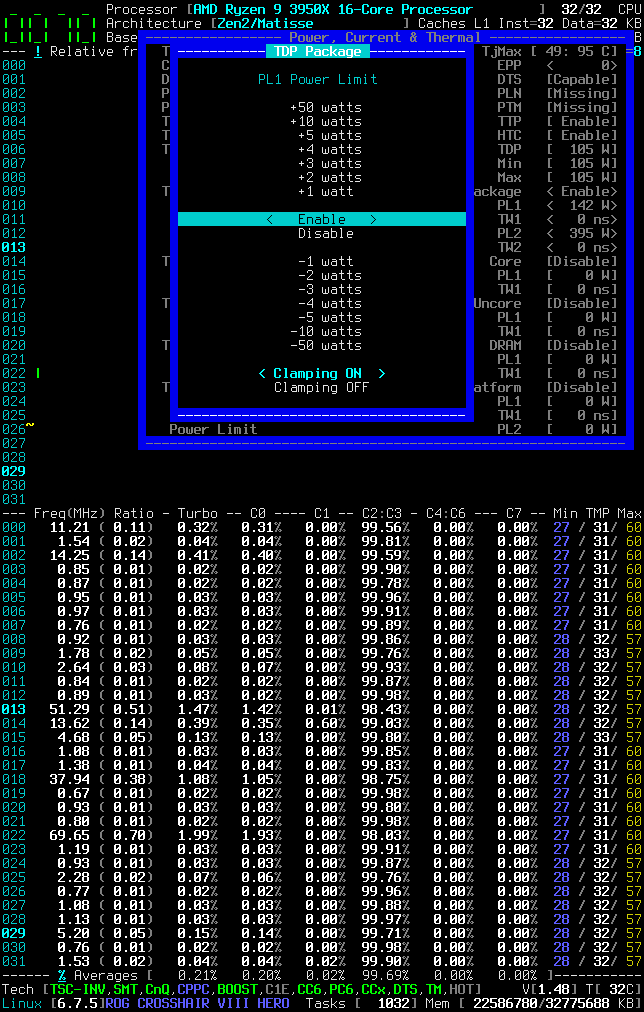

Power Limit can be altered in "Power, Current & Thermal" window but it has not been implemented on all AMDs
