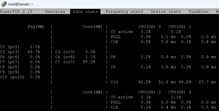

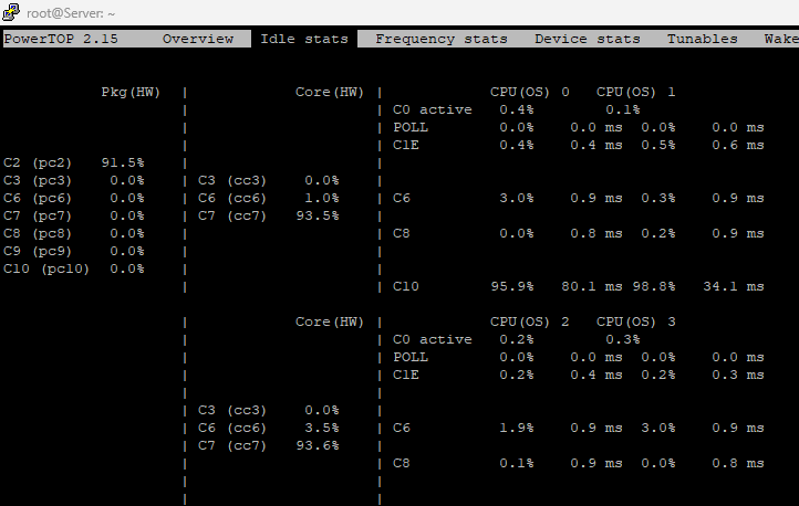

  1. Hey there, basically 6.12.4 is the last version where I can reach C10 with my I5 13500. All versions above only allow C2. Nothing changed only the upgrade of Unraid. Is this issue known?
  2. So I tested now a lot of scenarios: 1. M2 first slot no c state at all. 2. M2 second slot C8. 3. M2 second slot and asm1166 card with ssd 2tb C10 - wtf 4. M2 second slot and asm1166 card with ssd 2tb and 3x16 hdd - C8 5. M2 second slot without asm1166card with ssd 2tb and 3x16 hdd - also C8 It looks like the asm1166 card isn't necessary for me. I am running now some dockers like plex, arrs and C8 is being held while using 15 watts. Thats impressive. I think I am going to use my 2tb ssd only for cache and vms and removing the m2s totally.
  3. I detached HDMI but didn't reach C10. Maybe I would have to wait longer than 3 minutes 😄. But I am pretty happy with C8. Now I will put every drive little by little and check every time if I keep the c state.
  4. You were right. I downgraded to 6.12.4 and I am now reaching C8 with 10 Watt. Thanks! But is it really the problem of this motherboard or with every motherboard at the current version? Did someone ever reached C10 😄?

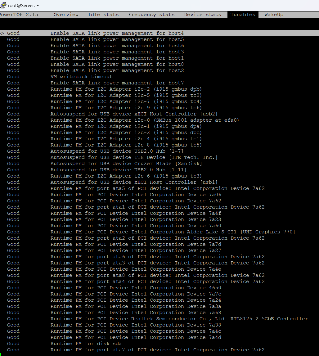

  5. Hey there, I built a new server with this config: Hardware: Gigabyte B760M Gaming X DDR4 Intel i7-12500T 2x M2 Patriot P300 M.2 PCIe Gen 3x4 256 GB SSD (MirroredCache) PNY CS900-2TB (VMs) 3x16 TB Toshiba Enterprise MG08ACA (Parity & Storage) BeQuiet PURE POWER 12 M 750W ASM1166 6xSATA Card I set the Bios Settings like mgutt but I can't even reach C-State 3. I stopped the VMs, Dockers,their services and the hdds connecting via ssh to watch with powertop. The setup is running in this stage with 30w. I removed every storage except one m2 Patriot. Still the same C2 but with 28W Idle. Then I removed the m2. Now I can get to C3 with 18W. But how is this possible that even without anything except the usb flash I still can't go lower than C3? EDIT: I removed all Plugins to be sure that nothing blocks this. But same result as before. EDIT2: I did a bios update from F15 to F16 without a change. What is different to mgutt settings is that PEG PCH DMI ASPM are enabled but greyed out. So maybe a problem with the Intel 12th series like someone stated here.
