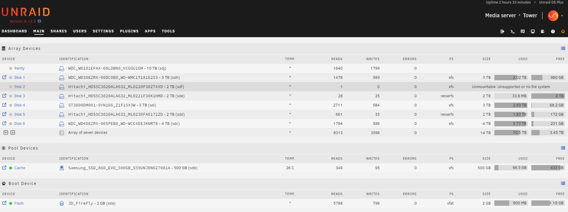

I am in the process of converting my old reiserfs disks to xfs. I checked parity prior to starting this process and all was good. I disabled VMs and Docker and made sure the mover was not scheduled. Since I had one drive already formatted in xfs (disk 6), I used unbalancer to move files off a reiserfs disk and onto the xfs disk 6. I repeated this process down the line, moving files off the next biggest reiserfs disk and onto the newly converted xfs disk.
The first couple disk conversions (disk 1 and 4) went as planned after formatting. Doing the same process with disk 2, it initially appeared to work fine and was formatted into xfs after clearing. I then began to move the files on disk 3 to disk 2, which completed as expected. When I shut down the array to format disk 3 to xfs and started the array up again, I noticed disk 2 was also coming up as unmountable. I did not format either disk 2 (for a second time) or 3 once I noticed this was an issue. I changed the format of disk 3 back to reiserfs so it would mount, but nothing was ever formatted.
I have read a few posts on xfs repair, but am checking for the best route forward. Is this an issue of the disk being too close to capacity? I also updated from Unraid 6.12.4 to 6.12.5 in between disks being moved (not during unbalancer running), but not sure if that is an issue.

Are you sure disk2 was formatted XFS? Doesn't appear to have a valid XFS filesystem, but on can check filesystem using the GUI, it won't hurt if it's not XFS.
