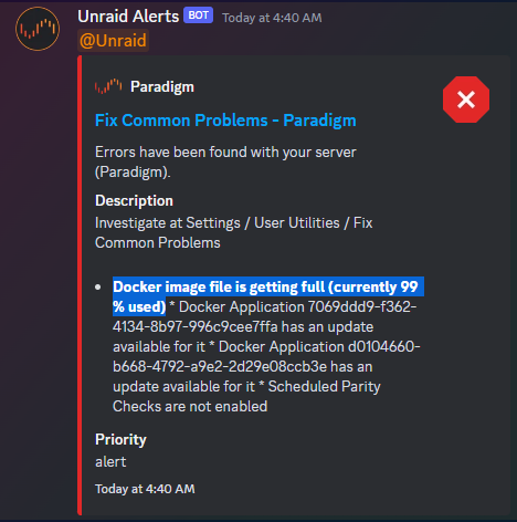

I am getting daily notifications that my docker.img is full though I am certain it is not;
My docker.img is an absurdly large 110GB
Here is a list of my containers and their sizes: https://pastebin.com/raw/VtYgHNAB
This adds up to 56GB - Just over half... Where is the other 54GB??
