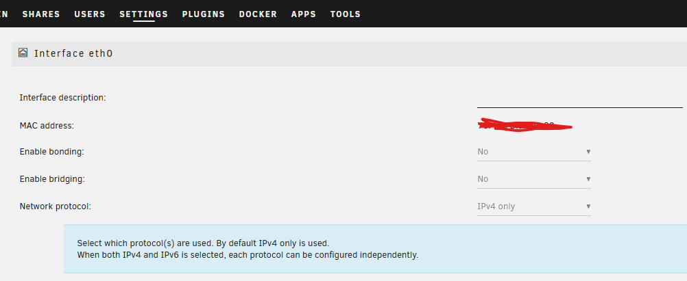

Your server appears (to me)  getting a IPv6 address.  Is this what you wanted (or expected)?
If you only want an IPv4 address, select that here (using 'Network Settings):
I wanted a IP 4 address. I did change the network settings and once I clicked apply the system log had a yellow alert that said bind to 0.0.0.0:80 failed address already in use. Same for port 443
Post Diagnostics after a reboot with Network Protocol set to 'IPv4 only'...

So, in a final last ditch effort i took the Lan cable leading to my server and directly plugged it into the switch which leads to the main router. Deleted the network config files on the usb, rebooted the server and now its being picked up no issues.
