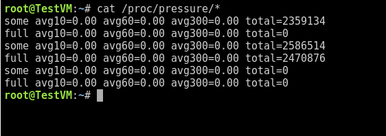

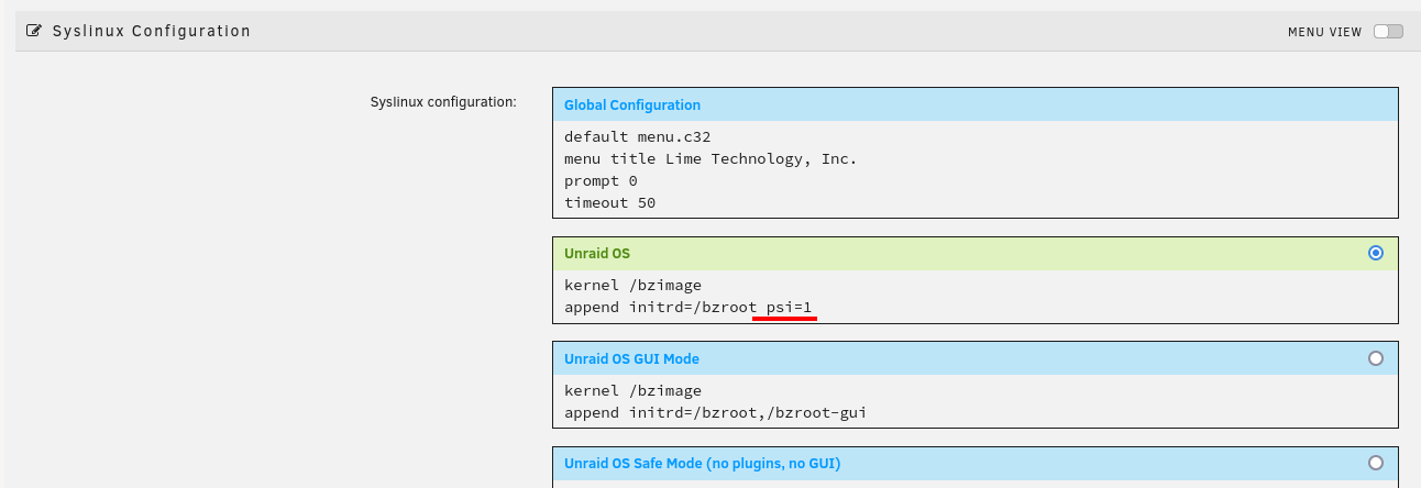

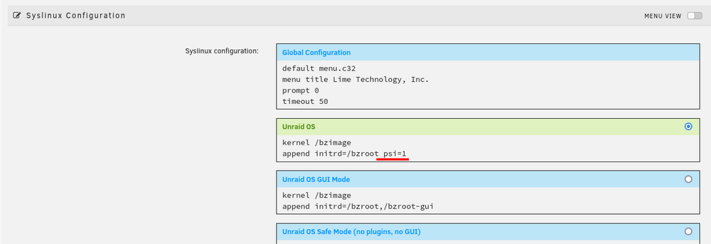

@EliceAM PSI is now included in Unraid 7.1.0-rc.4
Please note that you have to activate it manually by adding psi=1 to your syslinux.config like:
and reboot, afterwards you can check if it's activated with:

After adding psi=1 to the boot parameters in the RC4 version, Redroid is now basically running normally. Although there are still some binder errors during startup, they do not appear to affect app functionality. Therefore, Redroid can be considered to be working correctly.
Additionally, after enabling PSI, the 'Connection failed' message no longer appears in logcat.
