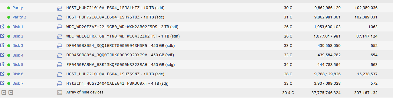

I have a two parity array with two disks on the array that are constantly writing and cant seem to figure out/fix the issue. I have appdata moved onto the cache drive with an appdata backup service running. After running the mover array --> cache multiple times it still doesn't seem to get everything off of the array and onto the cache drive.

To add - I had other appdata directories on different disks that were old and unused containers. I manually deleted them and on those disks the constant writes appear to have stopped. The last disk is disk2 which remains to constantly r/w with an appdata directory containing a plex media server folder. For some reason, the mover will NOT move this directory off of the array even with disabling docker. I have also turned the plex container off and the r/w continue.

It looks like the disk continues with constant writes. I have file activity plugin installed and enabled and it shows absolutely nothing. Could the constant writes on disk2 with both parity's just be normal?

Your ‘system’ share was on disk2 in the last diagnostics, and that share contains the docker,img file which is probably causing your issue.   You normally want that share to be on a pool if at all possible both to minimise array reads/writes and also maximise  performance of docker containers..

Gotcha. Shutdown docker, set system share to cache only, run mover and in theory problem solved? I am assuming docker will need to be told where the vdisk was moved to?
edit: Moved system share over to cache drive and will figure out backup solutions. Looks like no more unnecessary read / writes are on the array! Thanks for your help!
