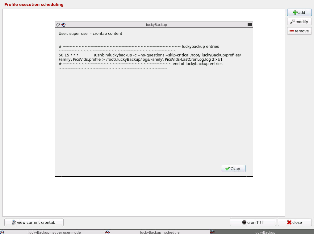

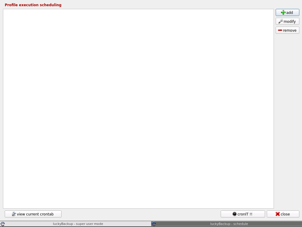

  8. Yes confirmed that. I will create a cron task it will appear in the list allowing modification and removal everything will look great. I will restart the container and it will disappear from the list but will remain in the view current crontab page. Also is there a way to see the status and completion status of current cron job tasks? update: It looks as if through testing the cron will work although I am unable to modify or delete existing ones.
  9. Using Lucky Backup. Cron jobs will not run. Method - create cron job to run daily at 3 mins in future to test, container will have been reset after confirming cron job has been made. After restart cron will disappear from list, although when clicking "view current cron tab" it looks like it shows. The task will not show that it has ran via the gui. Container is being ran as root to access appdata and share files. Appreciate the help!
