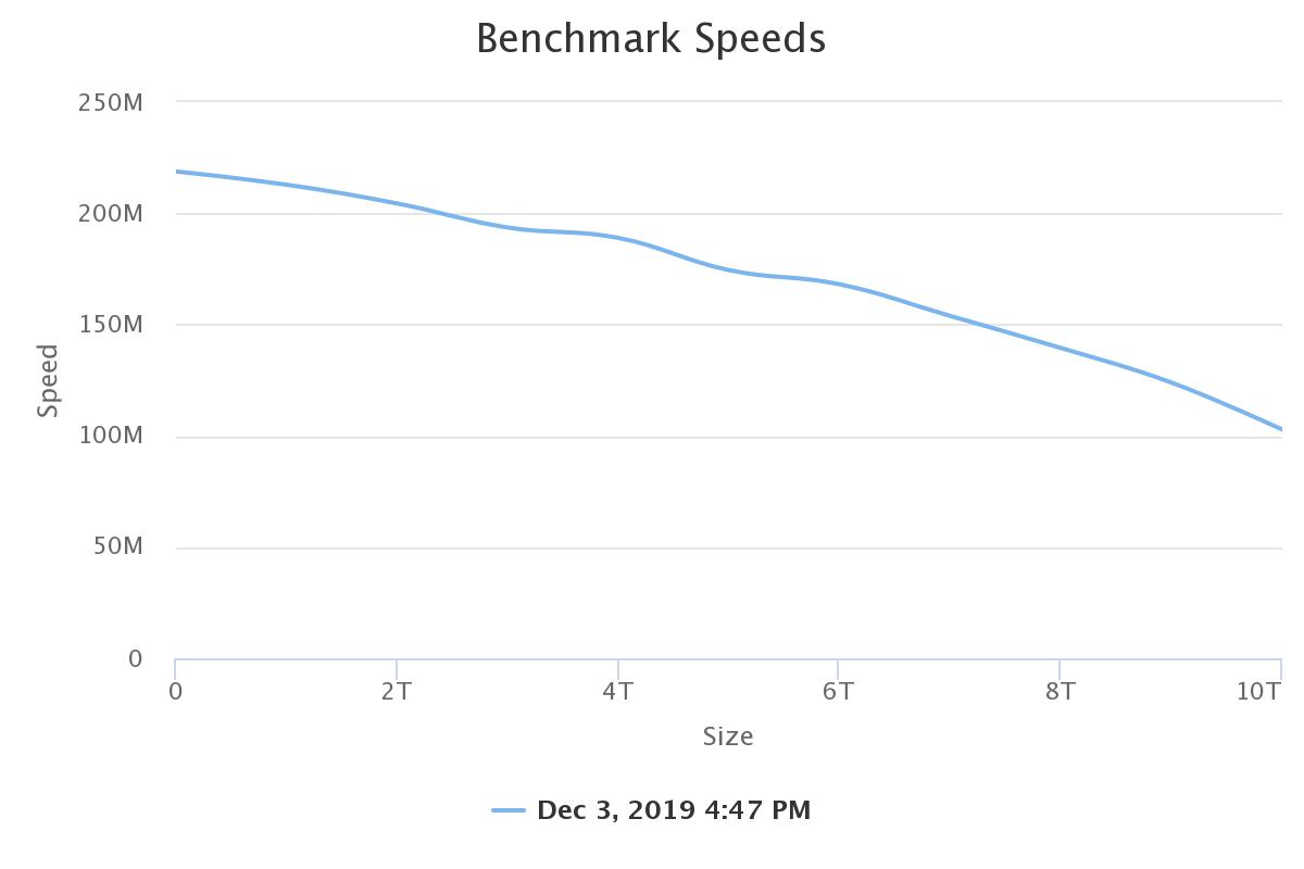

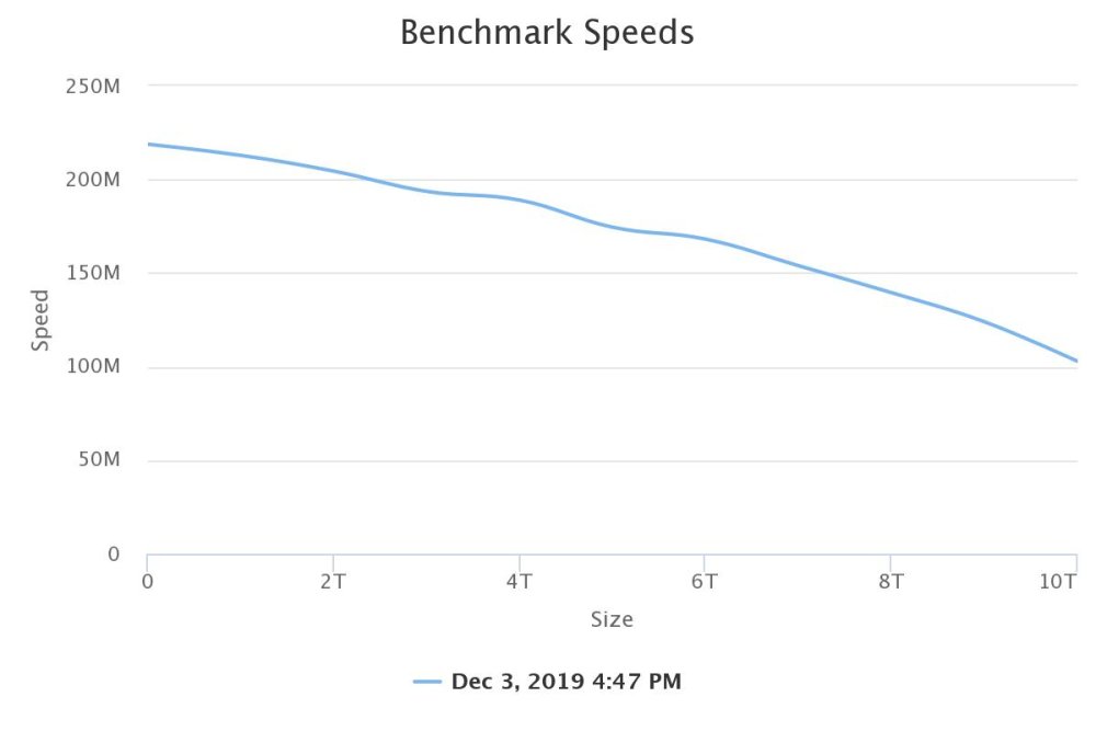

starts at 218, drops to 103 at the end.
my last parity check of 5+1 drives...
Duration: 18 hours, 9 minutes, 19 seconds. Average speed: 153.0 MB/sec
