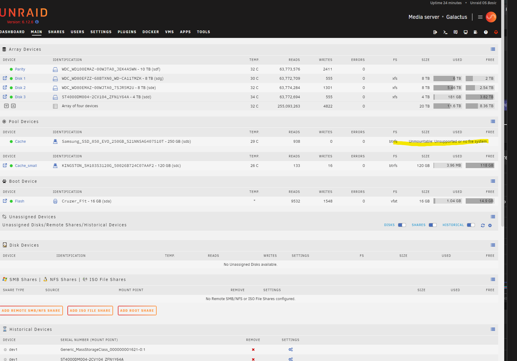

only now, I notice one of my 2 cache drives is showing as "Unmountable: unsupported or no filesystem". And the hard part is I dont know if it was like that before the update or not. I assume not, and I assume that is my problem.

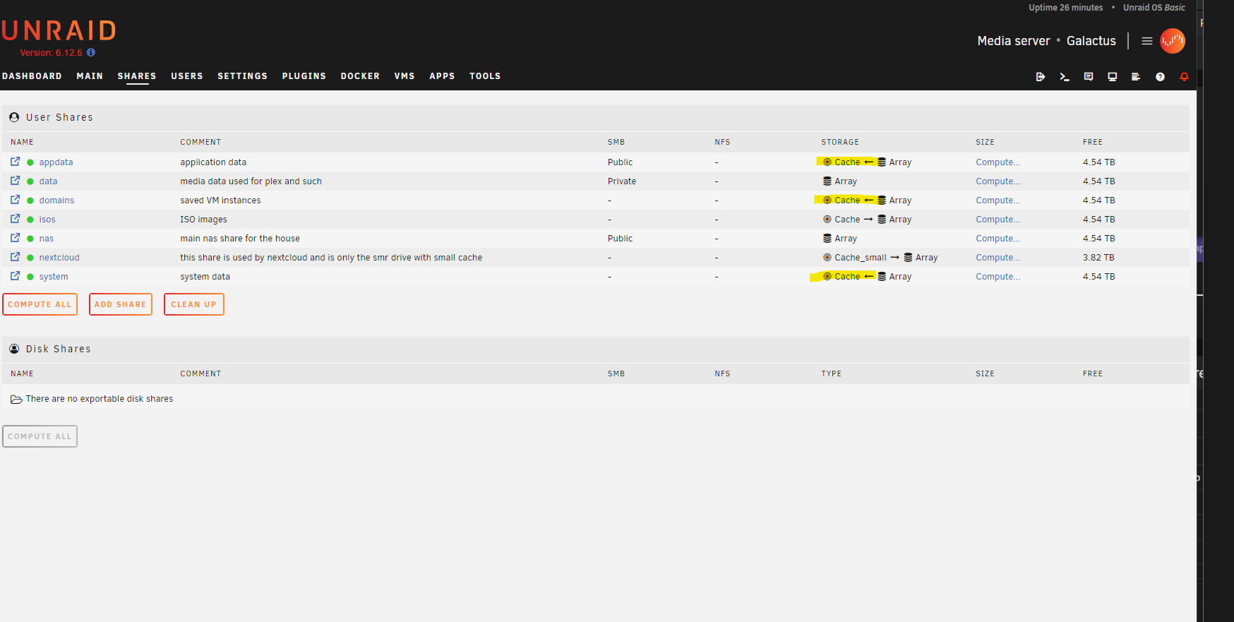

Also, it looks like app_data, domains, and system shares are/were pointed to that cache drive.

weirdly enough, the drive shows smart status of healthy
 After work I was able to do some digging. Fix-Common-problems linked me to the faq-6 post here
using the first recommended step, i was able to get the drive to mount.
