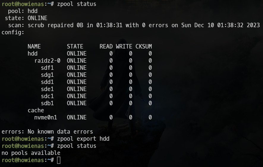

I accidentally chose the new configuration, so I lost my zfs pool. When I used the zpool import command and reconfigured the pool, my share could operate normally, but the disk array operation still showed that there were disks that could not be mounted.

If you manually imported the pool you must manually export it before starting the array, stop the array, type:
zpool export hdd
start the array, post new diags, if it still doesn't mount

I did the following: offline disk array, export pool, online disk array, I still can't function properly, and the pool device still prompts: Unable to mount: unsupported file system or no file system
You have a cache vdev that is not assigned to the pool, that won't work, but first the log is being spammed with PCIe errors, try this, then reboot and post new diags.

Ok, it's clean so far, don't import the pool manually, unassign all pool devices, start array, stop array, this wiil reset the pool.
Now change pool slots to 7, assign all devices to the pool including the NVMe device, important, assign them in the same order as the zpool status output: sdf, sdg, sdd, etc
Start the array and post new diags if the pool doesn't mount.

Thank you very much for your help, everything is back to normal, the data is normal, have a good day
