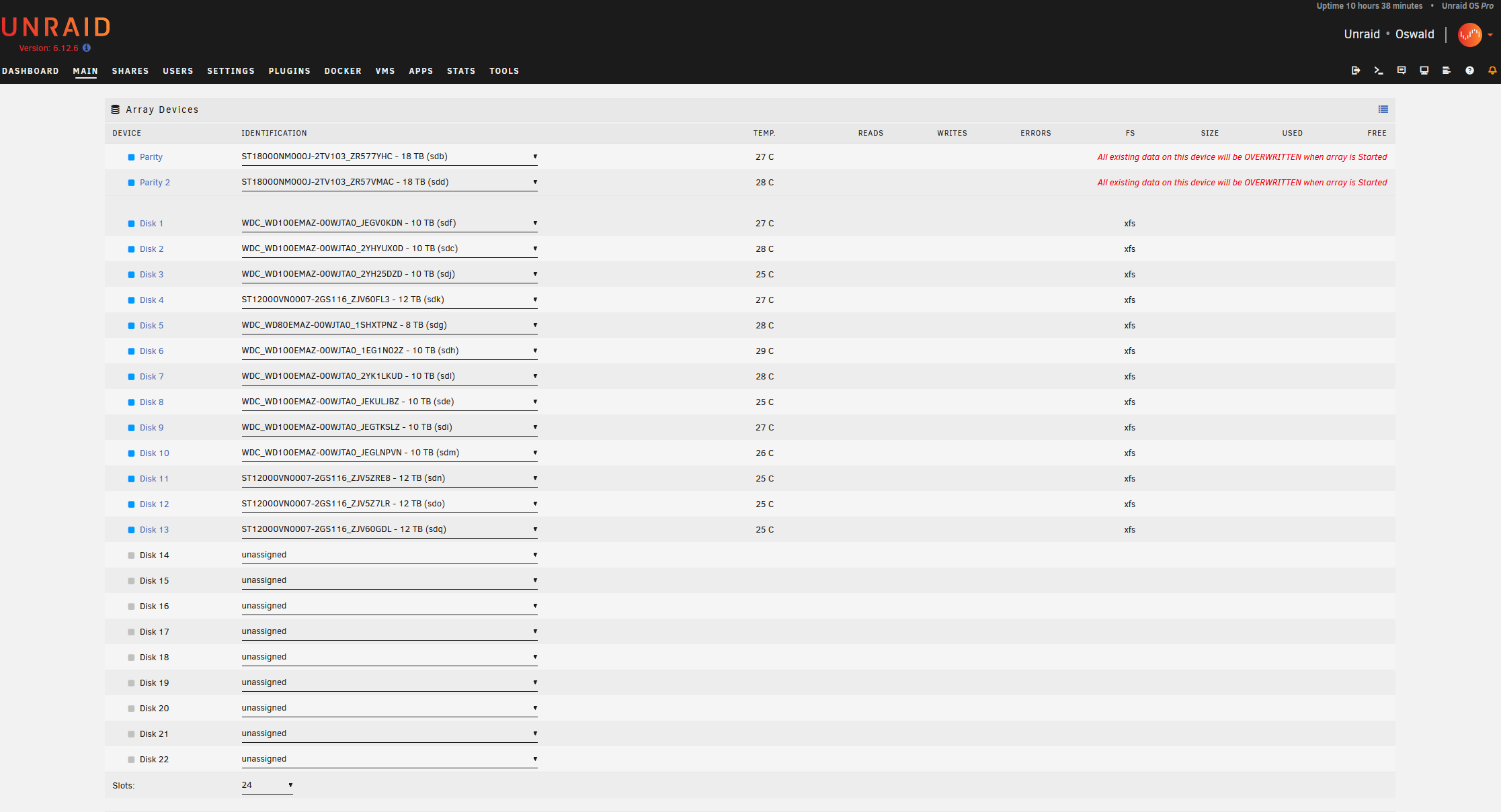

I had my usb drive fail, I copied over a 2 month old config backup.  I had one drive in the array before during the backup that is no longer there I removed it and added 3 others in its place.  All of my drives are labeled in the das Disk 1 , disk 2 etc and this corresponds with my unraid config, so I know exactly which drive is assigned what.  I matched them up accordingly and click start the array, then proceed, then …. Nothing at all happens.   I really don’t want to mess things up any worse than they are now, so can someone please advise me on what my next steps should be? I have dual parity and both of those are physically labeled as well, so at least there is no guessing which drive was which.  I’m just not sure where I’m going wrong now.

I don't see any attempt to start the array, or is the problem that you cannot start it?
Post a screenshot of main.

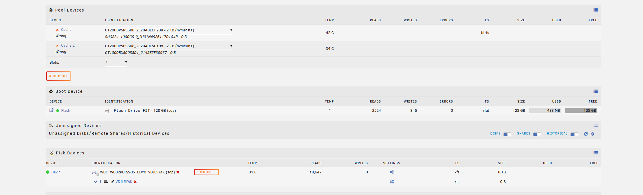

I just noticed both cache say "Wrong"  the backup I have must have had the old SSD cache and in those 2 months I switched to 2x NVME Cache.
I'm thinking I need to do something with the New Config I read in the manual but I'm a little gun shy and would like some confirmation first.
Unassign the pool devices, if all the array disks are all correctly assigned check "parity is already valid" and start the array, then stop the array, re-assign the pool devices, start the array and post new diags.

The screenshot seems to imply that the array assignments in that old backup were correct. Are you sure that backup was before the array changes?

"The screenshot seems to imply that the array assignments in that old backup were correct. Are you sure that backup was before the array changes?"  As for this no to the data drives.  The backup could have happened after the data drives were already changed.  However the backup definitely predates the upgrade from SSD cache to NVME cache.  Perhaps all I need to do is unassign both cache drives and then start the array, then re-add the cache drives somehow?  My concern with that is that my appdata lives on the cache drive.  I'm just being very cautious because I'd rather not have to restore triple digits of TBs of data or have data loss etc. Slow and steady recovery since I'm not 100% confident in much of it.
